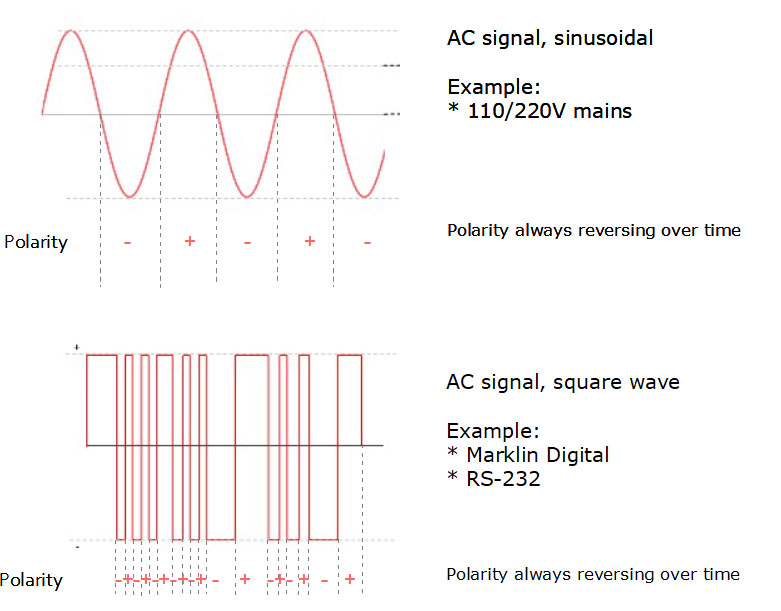

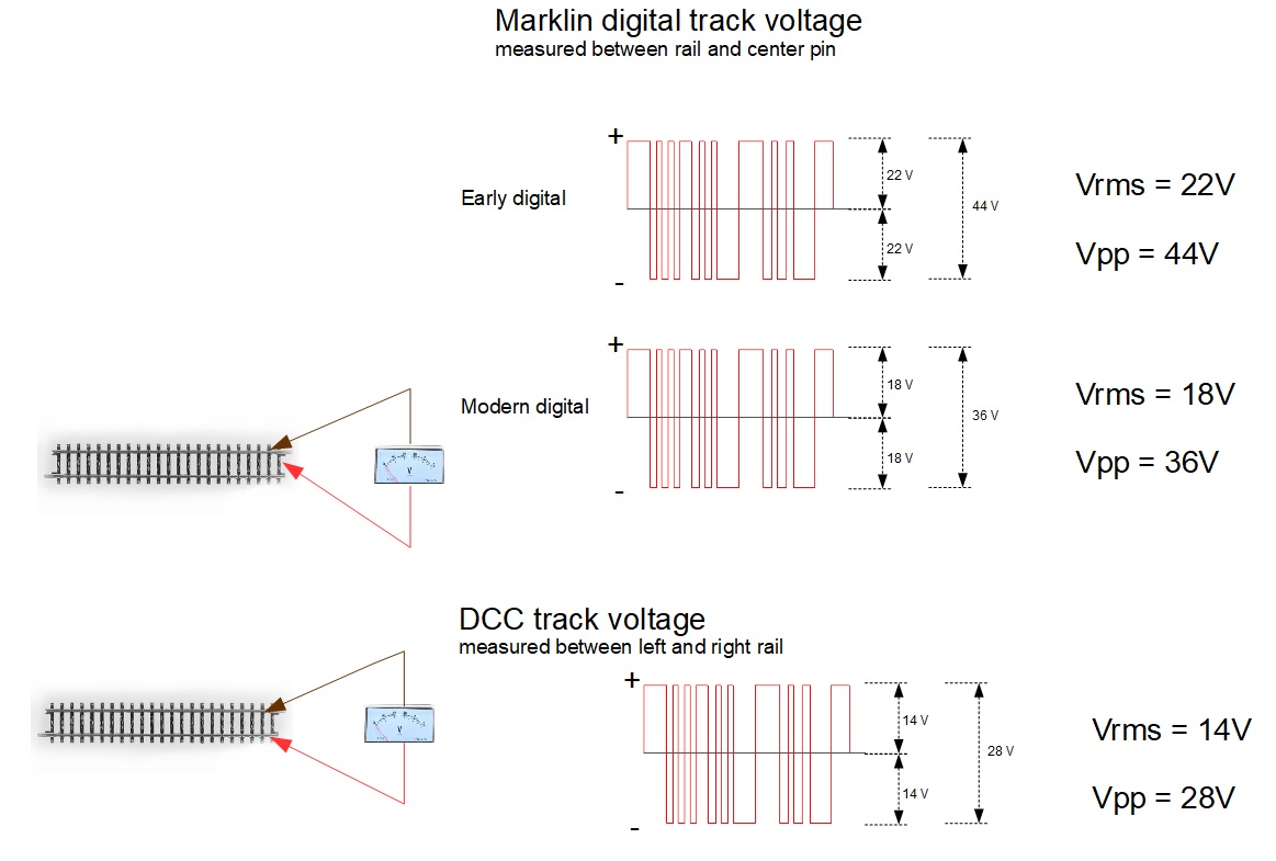

Below is the diagram showing track voltage details on Marklin digital 3-rail system, and DCC 2-rail system. Both Marklin digital and DCC actually output AC signal to the track, the voltage swing from positive to negative. In digital system, the difference in track voltage will not be a problem as long as not exceeding the maximum voltage of the decoder.
below is the diagram showing track voltage of Marklin analog and digital system.
thanks 3 users liked this useful post by tiono
#19 Posted : 17 March 2020 17:22:20(UTC)
Posts: 3,540
No, I'm sorry; but no Cool
The definition of AC is:
Alternating Current (AC) is a type of electrical current, in which the direction of the flow of
electrons switches back and forth at regular intervals
Or:
In electricity, alternating current (AC) occurs when charge carriers in a conductor or semiconductor
periodically reverse their direction of movement.
( Just found on Google, if you want a more scientific explanation, please ask )
Since neither Märklin digital or DCC changes polarity periodically or at regular intervals, you can't call it AC by the definitions
used by ( almost ) everybody all over the world for more than 100 years Cool
TEEWolfs use of strange nicknames doesn't change anything in this regard Mad
A digital signal is DC per definition; changing polarity according to the given protocol being used Cool
P.S: And the Z21 is still capable of making a Märklin Motorola digital signal, and thus controlling the loco in question Cool
file:///C:/Users/paa/Downloads/z21-maintenance-english.pdf
Offline tiono
#20 Posted : 17 March 2020 17:48:12(UTC)
tiono
Joined: 09/02/2010(UTC)
Posts: 234
The track voltage on Marklin digital is indeed AC signal.
It swing from +18V toward -18V (peak-to-peak voltage is 36V). And yes, the direction of electron flow is switched back and forth. You can measure (and see the waveform) on an oscilloscope.

#21 Posted : 17 March 2020 17:50:55(UTC)
Posts: 15,542
It can be +/- 16 V or +/- 22 V or a different voltage.

#28 Posted : 17 March 2020 22:22:15(UTC)
No, it's an alternating DC signal
I'm going to be naughty here.....Flapper BigGrin
How come I need to have my multimeter set to the 'AC' setting to be able to measure the voltage.....?
It's probably better to describe it for what it is - more or less a square wave - fast rise time, then a DC bit, then fast (whatever it is called) back to zero.
#29 Posted : 17 March 2020 22:33:30(UTC)
Posts: 15,542
It is not AC. And cheap multimeters without "True RMS" will not measure digital track voltage and will show nonsense instead.
Not back to zero, but reversed polarity instead.
Selectrix and RailCom have plus, minus, and zero. But with MM, DCC, or mfx there shouldn't be phases without voltage.

Offline tiono
#35 Posted : 18 March 2020 02:58:41(UTC)
tiono
Posts: 234
The main difference of AC signal versus DC signal is: the behaviour of its polarity (in other word: the electron flow direction).
AC signal will keep reversing its polarity over time, while a DC signal is not. Even if a DC signal is modulated with digital protocol to form a series of "0" and "1", its polarity does not change.
For example of AC signal in digital: RS-232 serial communication, specified that a logic "1" is represented by -15 to -3 volt, while logic "0" is reprensented by +3 to +15 volt. Therefore the signal polarity is reversing if the logic change from "0" to "1" or vice versa.
Example of modulated DC signal in digital: Arduino pin 1 during uploading. It will output a stream of "0" and "1". Logic "1" is represented by +5 volt (chip Atmega 328, 5V), while logic "0" is represented by 0 volt.
To illustrate in graphical form:
The electrical signal between amplifier and home loudspeaker, is also AC signal:
To test whether a signal is AC (alternating current) or DC (Direct current), we can use a very simple circuit and volt-meter, as show below:
If there are output voltage on both sides (1) then the input is AC, but if the output voltage is only at one side (either 2 or 3) then the input is DC.
thanks 2 users liked this useful post by tiono
