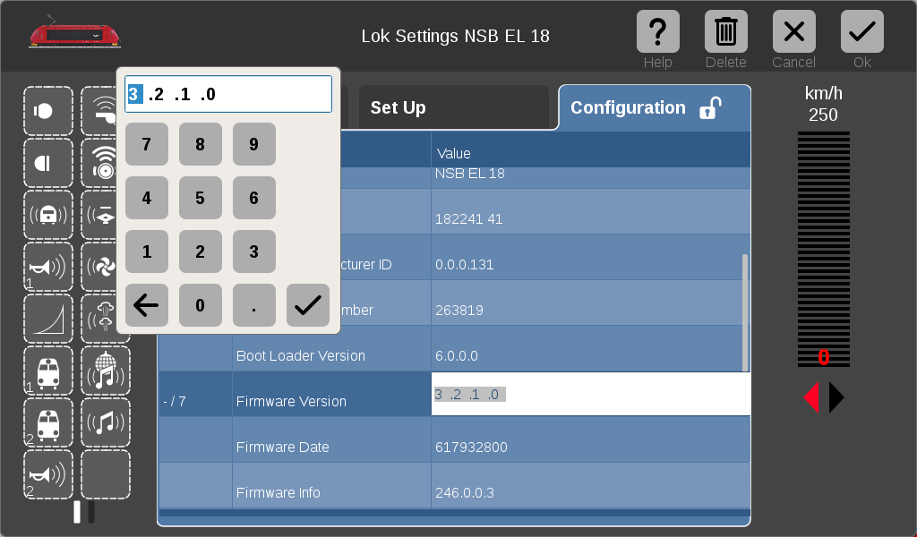

Does every new loco need to be calibrated by the CS3?
Its recommended :)
Here is a screenshot from the cs3, just replace the 3 with 77. pres ok, and give it some speed as described in the manual.
the decoder should also respond to CV 7 command in MM and DCC mode. (also works with the old 6021)

Posts: 9,828
That's nuts!
I did see the -/7, but I thought it was just some weird code for the firmware version.
How on earth is anyone supposed to work that one out? Marklin make great trains, but they really need to outsource their software development to another organisation (e.g. ESU) that know what they are doing!
@bph -> Thank you for sharing the screenshot. There is no way I could have worked that one out for myself.
Read the section titled "Automatic Calibration for All Protocols" on page 30 of the manual

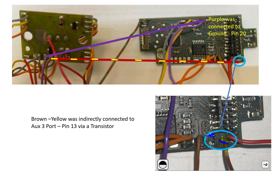

Okay.. I have the sounds and motor working correctly, but I am still struggling with the red swiss light. I have confirmed that there is a red led and it seems to be powered or grounded through a blue wire. However, I can't determine the correct auxiliary and I am unable to link it properly using a CS3.
Some images...
The CS3 hardware information
This is the blue wire on the decoder base - it seems to connect to pin 20 on the 21 pin socket.
This is the two blue wires on the middle board. Left lower wire comes from the above-mentioned board, while the right-hand one goes to the LED lights.
This is an image of the LED board - rear one.. The blue wire is connected to a pin above the gray one (i.e. they are separate pins)
This is the CS3 screen for the current settings for F0. These lights work correctly.. Three whites in the front and one white light at the rear right side.
This setting is from the default project download from Marklin for F1 (Swiss Lights). I don't think that there is an AUX 3, but I tried AUX 1-6 in that position with no change..
I know that something is not set correctly, but I can't figure it out.. I wish that I had access to a 39563 with a working original decoder so I could see how it is set up in the CS3..
The control circuit on the left in pic was serving 3 purpose -
1.Providing Connection to Pantograph and Centre pickup shoe
2.Swiss LED Lights as was mentioned earlier in the post by bph was very useful study the functions of the LED, reposting the same link for ease of reference (Courtesy bph: https://moba-hgh.de/mode...weizer-lichtwechsel.html
3.To receive the Orange and Brown wires from Loco chassis and connect to decoder.
The only reason to keep this secondary board was for the 2nd point. (Switching yellow/red combination)
Here is the wiring connection diagram i made, so that it could of some use to people who want to retro fit Motor and Sound functions into the complex SSB 6/8 crocodile loco Marklin 39562
The only hurdle i faced was, the 2 wires from the Light Control Board (Purple and Brown with yellow strips - refer picture), There is no option to connect this wire, i really wondered where to connect it ?, if left open without any connection what would be the impact.
So i went back to the old Mother board and traced where these wires connected.
Here if you observe the purple was connected to Ground - Pin 20 of the Decoder and Brown-yellow was connected Indirectly connected to Aux 3 Port via what appeared to 3-pin MOSFET transistor, which is usually used to drive SMD LED's. Since it was connected to Aux 3 Port, it gave me relief that this was only optional and i can do away with its functionality and and decided to leave the Purple and Brown-Yellow wire open.
The Central Station, i only calibrated the CV 51 value to set it to 5 - (Soft DC motor)
