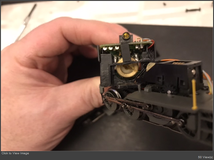

I guess it was inevitable, but last time I checked her maybe 5 years ago my Seetal Croc 37521 still appeared to be unaffected.
Most of my Marklin has been packed away for 5 or more years now, while I have been slowly having my eyes repaired.
Today I tried to run her and the motor spun but nothing moved.
Taking the top off......
5CA650C5-09E6-4AEA-AECA-0797C249B25B.jpeg6F87671A-CF6D-407D-8924-35A6633D4F35.jpegCBFC51FC-6D7B-4185-809E-33714B3869BC.jpeg

The frame is actually the least affected and harder to spot until you look at the end view in the third photo.
Both the gear towers / bogie frames have swollen and crumbled!
Looking online and searching earlier threads it seems the only route now is through the Italian company that has re created the frame and gear towers. The cost is quite high though, the main frame and two gear towers / bogie kits is going to be GBP 130.
Pretty sure I paid less than GBP 200 for the entire loco when it was new out in 2002.
https://www.ebay.co.uk/i...52963:g:06sAAOSwh1paTPYO
https://www.ebay.co.uk/i...068a1:g:S4UAAOSwwPdcCBca
To date they have sold 122 frames and 52 bogie gear tower kits, so I am not alone!
I guess the cost is worth it in today’s market and I will have to take it on the chin.

As has been reported the last time this issue was raised, Marklin have no stock of spares for these part numbers.
