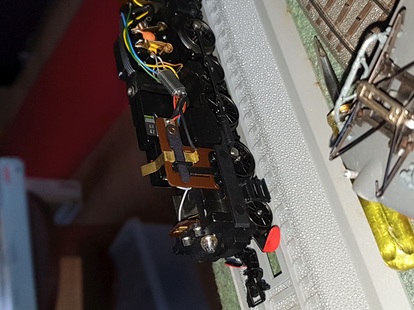

Here are two pictures if anyone can spot something that might be wrong please let me know!

#9 Posted : 08 January 2020 12:56:56(UTC)
Posts: 15,873
The settings on your decoder are 1-3-6-8 on, which corresponds to address 36. It's quite common to read the decoder DIP switches upside down. I've done it myself many times!
"On" is with the switches set in the direction of the word "ON" on the decoder.

#10 Posted : 08 January 2020 13:03:43(UTC)
The Crocodile
Iceland
Joined: 22/12/2019(UTC)
Posts: 111
Thank you so much, this was indeed the case, I switched them back and the loco runs fine now, and looks Beautiful. Thank you all who replied, I appreciate it a lot. I hope to be able to perhaps return the favour one day! Here is a picture of the set actually working:)
