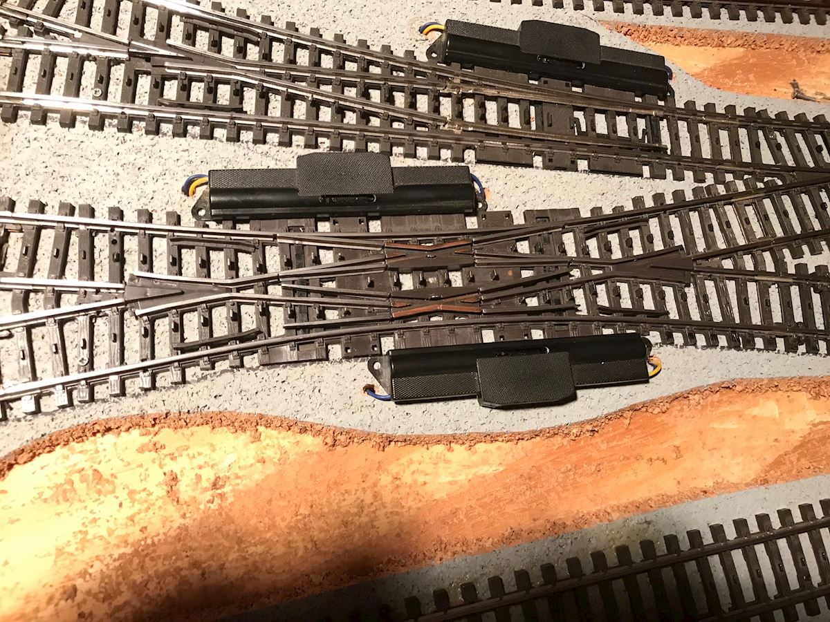

Recently my DKW lost power on the 2 points indicated with the red line.
Since the DKW is installed I would like to restore power to the 2 points by using a suitable electric conductive paint to connect them to the points indicated by the blue lines. I feel this should work since there is no possible contact to train wheels or ground.
I would appreciate your thoughts on this and possibly a suggestion which conduct paint to get.
Thanks,
Pfalzbahn

#3 Posted : 08 October 2019 10:32:31(UTC)
Posts: 3,737
Hi Pfalzbahn
Not willing to be too pessimistic but you have to remove the double slip switch and open it.
Conductive paint will not do: not enough conductivity and here this is the right spot to obtain short-circuits.
It is likely a short that caused the initial issue (the Puko is very close to the wheels)

#5 Posted : 08 October 2019 15:12:40(UTC)
Posts: 3,737
Hi again Pfalzbahn
Looking more closely at your picture (making it much bigger) it seems very much that this is a dummy pucko aimed at raising the slider so that it does not touch the rails in the middle (look at the fixed frog pucko that seems to be made of insulating material) So you may have a slider issue and not a Double slip issue. Of course I may be wrong.

#8 Posted : 10 October 2019 23:28:00(UTC)
Posts: 3,737
Hi Pfaltzbahn
I found this thread on Stummi Forum about the 2275 DKW (double slip point) -->https://www.stummiforum.de/viewtopic.php?t=105938 Look at it slightly past half way. It dates back 2014.
At the time it was found to cause almost always shorts. The solution was to increase the Wheel spacing to 14.1 mm and to add some paint on the side of the pucko to avoid shorts with passing wheels.
I know it is not exactly your problem BUT
- Either Märklin has changed their 2275 to have a dummy pucko there (I don"t know, would they continue to deliver non operative units?)
- Or the Pucko is left unchanged and in this case it is made of thick stamped and bent metal (surface treated iron) on which there is almost no chance that anything can stop the pucko to bring power.
So please check again your unit. Thanks

Offline Pfalzbahn
#10 Posted : 11 October 2019 02:16:07(UTC)
Pfalzbahn
Joined: 05/10/2019(UTC)
Posts: 76
Location: Pennsylvania,
Thanks everybody for your thoughts.
The 2 pukos in question are powered at all my other DKW's! I experience the loss of power with all my engines.
Probably I have to take the DKW out and open it up to see what's wrong.

Offline Pfalzbahn
#12 Posted : 16 October 2019 00:26:30(UTC)
Pfalzbahn
Posts: 76
John,
the 2 pukos in question are dead, they have no current contrary to those pukos in my other DKW!

Offline Pfalzbahn
#16 Posted : 22 October 2019 01:27:44(UTC)
Pfalzbahn
Posts: 76
John,
I don't understand this sentence " if they are dead which is impossible you've got a dead double switch."
The multimeter tells clearly that the 2 pukos in question are dead.
When the shoe of the loco touches those pukos there is no short - the loco just stops. The wheels do not touch the pukos.
Pfalzbahn

Offline Pfalzbahn
#18 Posted : 22 October 2019 23:44:07(UTC)
Pfalzbahn
Posts: 76
John,
The multimeter touches always one puko and the track (ground) and there is no current. On my other DKW's I always see the current on those pukos in question.
Pfalzbahn

#19 Posted : 23 October 2019 08:55:08(UTC)
Posts: 3,666
Originally Posted by: Pfalzbahn Go to Quoted Post
John,
Okay, so we have to look for something more exceptional.
As you state in your first post that it has lost power "recently", I understand that it once worked.
So, what can cut power on an installed turnout after (maybe) years?
RUST! As you say that the track is "installed", does that mean that it has been ballasted? -K-track is notoriously known for rusting the puko strings, once even just slightly in contact with water.
Maybe you can get to look at the underside of some other piece of track (easier accessible), to see if rust has started on your layout.
#20 Posted : 23 October 2019 15:01:13(UTC)

Offline Pfalzbahn
#21 Posted : 24 October 2019 18:24:10(UTC)
Pfalzbahn
Posts: 76
Henrik,
I am fairly confident to rule out a rust problem. My layout is never exposed to more than 50% relative humidity.
Jean,
I will verify the continuity.
Thank you both for your thoughts,
Pfalzbahn

Offline Pfalzbahn
#24 Posted : 28 October 2019 23:28:01(UTC)
Pfalzbahn
Posts: 76
Jean,
there is no continuity between the problem pukos and the other pukos.
Pfalzbahn

Offline Pfalzbahn
#26 Posted : 31 October 2019 02:00:08(UTC)
Pfalzbahn
Posts: 76
John,
thanks for your comment. Here is the 'whole' picture of the double switch:
The switch is not glued to the cork bed. I cannot explain why there is no contact of the problem pukos with the other pukos. All my other 9 double switches are installed the same way and they are working fine.
I've submitted the problem to a Maerklin "specialist" in Germany and I am awaiting for his response. If the response doesn't lead anywhere I will - hate doing it - open the track connectors and remove the double switch in order to see the bottom.
Besides the electrical conducting paint I would also consider to solder a tiny insulated copper wire from the problem puko to the adjacent puko. As long as the copper wire is below the height of the pukos there should be no interference with the pick-up shoes. And the wheels don't pass through that area.
Pfalzbahn
