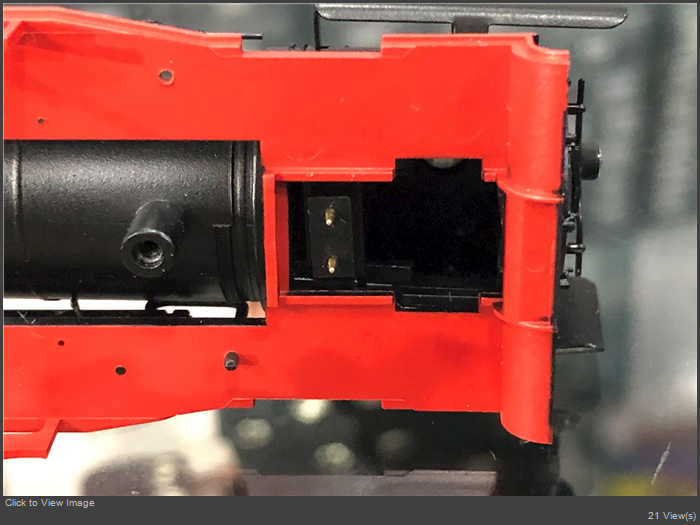

I really could not resist my curiosity to see if there is something minor that I could fix . I opened up the body shell . Didn't really see anything wrong with the wiring / soldering. All seems to be fine. I again put the loco on the track as is and my MS picked it up.
I did notice the cog wheel at the base of the loco. I used a fine screwdriver to rotate the cog wheel and it moved freely. This also made the loco's wheels to turn
There is another cog wheel at the base of the loco's boiler which sits on first cog wheel. This wheel too turned freely. This is now leading me to believe that the fault lies in the motor, which is inside the boiler. How do I test that ? IMG_5090.jpgIMG_5091.jpgIMG_5093.jpg
Offline TEEWolf

You should follow Applor's advice, and try to apply 12V DC ( Or 9V DC ) directly to the motor in the boiler.
The electrical connections from the motor in the boiler to the printed circuit board in the frame has to touch
each other very accurate, it could be those connections which are not working as intended.
Can you control the lights on the loco with your MS?
If the seller will give you half the price back, and you feel confident doing the repairs yourself; I would do so.

The motor works !!!BigGrin Tried touching the contact points ( pins) with the power current and the motor started to work, rotating the cog wheel in the boiler. it however strutters after every 5 seconds ......but it spins fine. Also, I am able to control the light with my MS. I can change the directions of the light as well.
So this could be as well an issue of the contact points not being properly fed ? The contact pins are spring loaded and extend from the boiler and touches the soldering pads at the base of the loco. I tried to observe as closely as possible but really cannot tell if the contact is good enough. So how do I rectify this now ? Also, the fact that the motor is making a strutting noice every 5 seconds means that it has gone bad ?
Also, another issue could be that the soldering pads where the boiler pins make contact themselves do not have power. Confused
If I manage to make good the contact, I may was well have some chance with the loco...Mellow

Try re-assembling the loco and check that the bottom of the boiler is sitting flush with the frame. If there is too much of a gap, the gears will not engage. Conversely, if the boiler to frame fit is too tight, the motor can bind up, or draw extra current because of the tension against the bearings. If it's binding, you can use shims to add a little clearance.

Which "power current" ? Be sure to only use a "clean" DC power. If in doubt, use a 9V battery.
I expect you don't have a multi meter; but if you have a small 24V bulb, you can see if there's power on the pads.
Maybe scratch a little on top of the pads with a screwdriver, to make sure they are clean - when there's no power on! BigGrin
If the motor runs and the pads have power, follow DTaylor91's advice Cool

I connected the main motor in the loco barrel using a 9V battery and a 9V battery connector as suggested BigGrin and confirm that the motor works.
This then lead me to check the soldering pads where the connector pins from the loco's barrel connect with the base.
I took the loco to a local electrical shop. The guy checked the soldering pads with a multi meter and confirmed that it was relaying power. The voltage also varied ( up and down ) while turning the MS dial up or down.
So, the loco connects to the track, my MS recognizes the same, I am able to control the lights .... all is fine. The motor in the barrel works when I connect the 9V battery and so does the soldering pads. So my problem could be related to one of the following :-
Bad connection meaning that the connector pins from the barrel are not contacting the the soldering pads properly. This is actually difficult to determine once the upper body lands on to the loco base. I requested the guy at the electrical shop to add a little more soldering to the pads just in case. I am also thinking to solder two wires from the soldering pads at the base to the connector pins in the barrel so that I negate the issue of bad connection. In this a good idea ? Confused
OR
The barrel is sitting too tight on the base making the gears fuse together and causing them to jam.
Any more suggestions ????

If the body is indeed too tight on the frame, try inserting a shim of paper between the two and test again. If nothing, or very little happens, and another layer of paper, and repeat until it runs freely. A more permanent solution can be made with thin sheet plastic of the appropriate thickness

Wanted to update and request suggestions on my case with the loco. Progress so far has been as follows :-
1.Fitted the contact shoe.
2.MS recognized the loco when put on the track as MM2-26
3.I am able to control the direction lights.
4.I guess that point # 2 and 3 means that the decoder is working and internal wiring of the loco is working ok.
5.Tested the main motor in the loco barrel using a 9V battery and connector. The motor works fine.
6.Tested the soldering pads on which the contact points of the motor in the barrel rests and found it to be relaying the current.
Now, this is where the problem starts.....when I put the barrel back on to the main body so that the contact pins touch the soldering pads, nothing happens. It won't turn on the motor. So I am guessing that this could be an issue of an improper contact. I even put extra soldering material on the pads so as to raise the hight of the pads but still the motor does not works.
I am now thinking of soldering two separate wires from the soldering pads to the contact pins.
Would appreciate any suggestions / guides ? Is my idea of soldering wires between the contact pads and pins good ? I just want to negate any possibility of an improper contact.

I suggest temporarily wiring the motor outputs from the decoder to the terminal pins on the boiler motor contacts - with the boiler off of course.
Then try and drive the loco and see if the motor spins.
It may be a contact problem or it may be the decoder motor outputs are not working. This will determine if its the decoder or not.
#39 Posted : 12 October 2019 14:15:00(UTC)
Posts: 8,635
Don't solder to the contacts, you will ruin them for their original purpose. Use small crocodile clips to make the connection.
