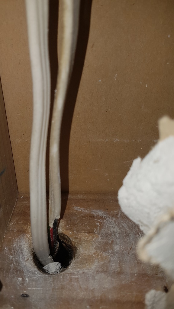

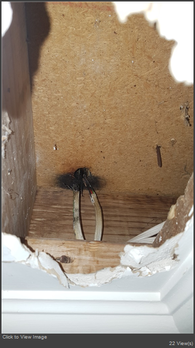

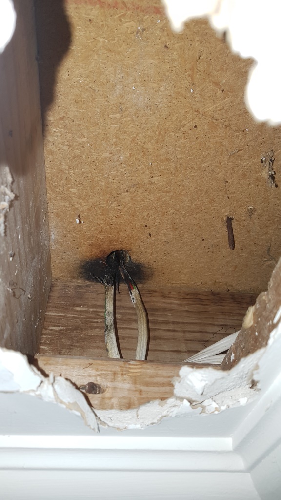

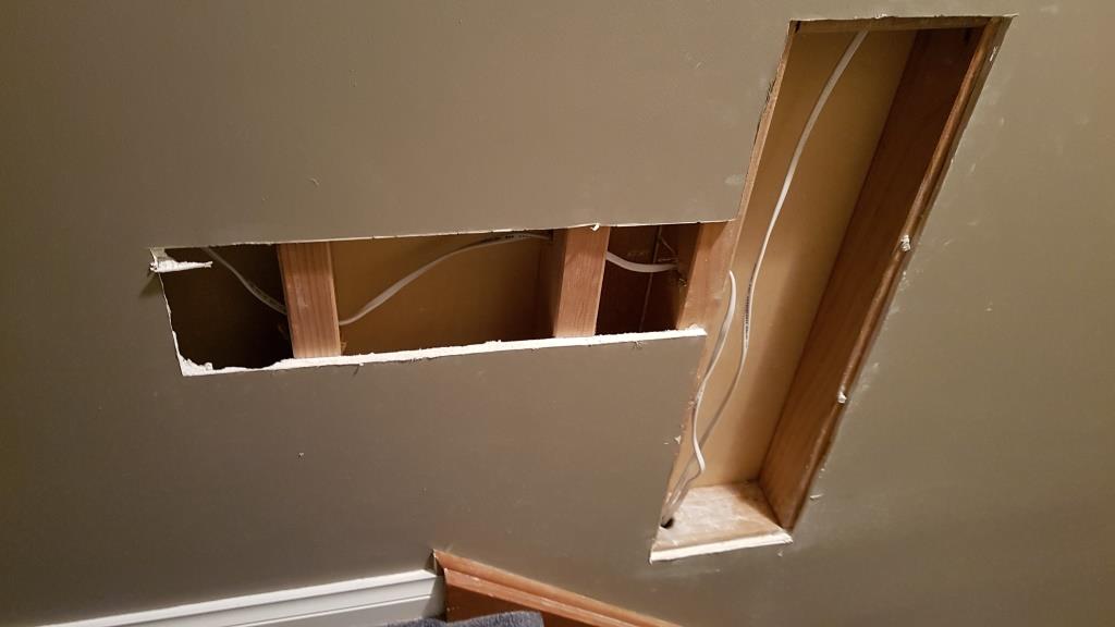

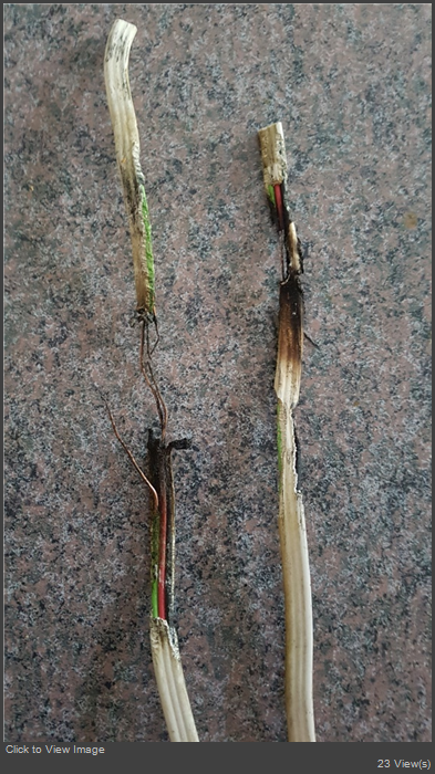

Well, you don't even have to have stuff plugged in and in standby to have fire risks......

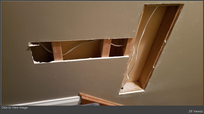

I think I posted in another thread a picture of some damage done to my house wiring by a mouse. The wires in question were intermediate straps for my hallway lights, where I can turn the lights on or off at any of the 4 switches in circuit. This meant that all three wires in the cable carry phase power, and they are only energised when the switches are in certain combinations. In trying to find the problem we (an electrician friend from our club and myself) got the switches into a combination where the lights started flickering badly and we could hear arcing and smell electrical burning.
After bashing holes in the plaster board downstairs and upstairs we found the issue. It looked like a mouse got into the cavity between ceiling joists and to find a way out tried to chomp through the cables that were going up through the wall.
The hole that the mouse tried crawling up through - you can see clear burn marks
The same hole from above
The wires we pulled out. New wires were spliced in to repair the damage. I also squirted (on Per's recommendation) some expanding foam into the hole to prevent a repeat.
My electrician friend said it was the worst he's ever seen. He is also an electrical engineering tutor at the local Polytech, so took the wires to work, where they were put on display for students to see!
Crispy mouse anyone??
A few holes had to be cut into ceilings and wall to find and repair the issue.
