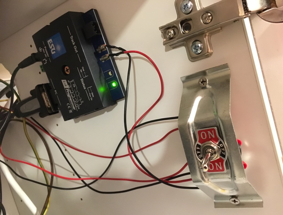

I’ve received my first ESU LokProgrammer, and I must say the software is very nice and user-friendly. I added a 2-pole alteration switch (On-Off-On), installed everything in the ”power cabinet”, and now I can use either the CS2 programming features or the ESU LokProgrammer without risking interference. Also, at ”Off” I have a power-free track when adding new trains to the layout. Me like! Cool

I am installing a rotary switch to connect the programming track alternatively to:
1. Intellibox normal track
2. Intellibox programming track
3. ESU Lokprogrammer
4. Märklin Mobile Station
My programming track is a separate roller bed and a dedicated section on the layout, so I can program trains without taking them off the track.
When rotary switch is not in Position 1, power to the rest of the layout (controlled by Intellibox) is shut down. This prevents a train from driving unintentionally from into the programming track, thus connecting the outputs from two differente control systems.
