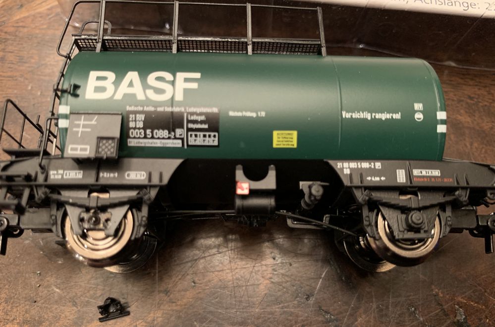

In prepping for my mini-BASF plant in the background of my Mannheim station, I've picked up 6 of the ESU Pullman Deutz tanker cars, and along with them the ESU specified AC wheelsets. Newb that I am I figured, the install of the AC wheelsets on my older Fleischman BBC transformer car went so well, this should be no problem. Not so.
First problem, due to the plastic detailing around the wheels, popping out the original DC wheelsets without also popping off or breaking off some small plastic bit around the wheels/springs area proved impossible for me on 30% of the axels.. so at some point I'll be gluing back on bits or broken bits once I have the cars running smoothly. There really is no room to touch almost without knocking something off. Lesson learned but grrr.
So once I got the AC wheelsets on the cars, I noticed that 2 of the 6 have some running problems, specifically that the cars don't roll smoothly because one of the 2 axels isn't rolling friction free. One of them, even binds in one direction but not the other. Headscratch.
The I dug around on Stummi and remember things I should have known from the start, realized that their could be one of several issues, but most related to poor wagon design or manufacture by ESU/Pullman.
AC wheelsets have a have a higher rim - and it could be the wheel rim is rubbing on some part of the underbody, which can be addressed with some grinding/filing. Bad design if thats the case.
It could be the wheelsets are not gauged right and the outside face of the wheels is rubbing on the plastic surround - I can check that with the guage as part of the closer inspection I have planned this weekend when I can put the cars under bright light and magnification and not just doing the work by a ceiling light at the kitchen table. That would be just the way the replacement wheelsets come, and may be a standard issue but again would be an ESU/Pullman manufacturing problem.
But given one axel binds in one direction but not the other, I'm thinking its also likely that one set of wheels is binding on the plastic brake shoes in one direction - the tolerances are tight, too tight unless you manufacture taking that into account. If they address this at assembly in the DC wheelset install at the factory, then the instructions on the AC wheelsets for the car really should include a tip and graphic of what to look for and adjust when installing the AC wheelsets.
From the Stummi search I found others had problems with Brawa freight cars in the past when installing AC wheelsets, so its not some novel problem.
I'm wondering, is this sort of thing I can expect to deal with whenever I replace DC wheels with AC wheels. (0/4 Fleischmann, and 3/12 ESU/Pullman axels)?
Does anyone have experience with a similar issue and can they provide a tip or photos on what to look for and grind/adjust?
One such car, not the broken off wheel hub trim bit lying next to the left wheel/axel; seemd unavoidable to get this or the smaller horizontal bit to just break off handling the things to try and pry out the DC axels.

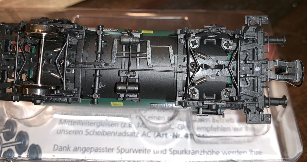

Inside face of where the axel seats; not the horizontal black bar that I snapped off on other cars often as well. Fiddly bits close to where one has to pry = bad idea in my book.
Bottom of one of the cars with an axel removed. Its busy down there, but the wheels are held in by friction between delicate plastic held and surrounded bits.
Closeup of the two axels of one car - one binds and one does not. When the wheels on their pointy ends don't sit center in the space, of course the surrounding plastic bits (brake shoes etc) could rub on the wheelsets, either the taller rims, or the differently gauged faces.

Done with the analysis; result is really poorly built ESU/Pullman tanker cars.
One one car, the larger AC wheelset flange was rubbing on the screw head that screws the coupler kinematic to the bottom of the car; the screw was loose or maybe even stripped. Tightend it up a bit and scrapped some crap off of the inside face of the wheel seat.
On the other car, it was indeed a misaligned plastic brake shoe pressing on the wheel. In fact, even the DC wheelsets were dragging. The brake shoe wasn't properly installed I guess, as I easily pulled it out - applied some new glue, and re-glued it with a bit more gap to the wheel. Rolling improved.
So based on my 6 car purchase, I'd say the ESU/Pullman design and build quality is shit as 1/3 of the cars had rolling problems with all wheels or once the ESU specified AC wheels were fitted. Prototypical correctness and high level of detail don't amount to squat 66% of the product won't roll.
