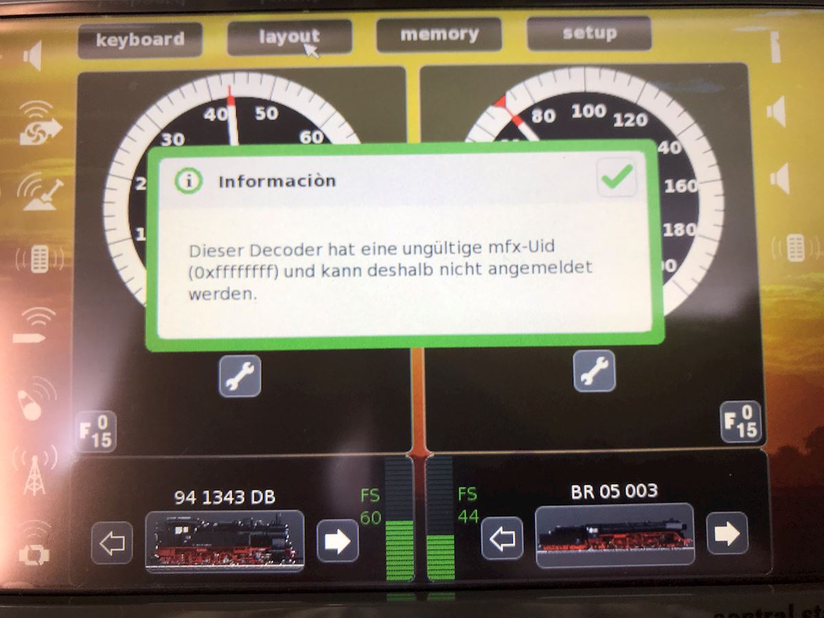

Offline jaseguvi
#13 Posted : 03 March 2019 19:50:53(UTC)
jaseguvi
Joined: 19/08/2011(UTC)
Posts: 18
Location: Malaga España
Originally Posted by: jaseguvi Go to Quoted Post
Goodnight. I had the same problem with the previous update, I have updated to 4.2.8 and everything works OK.
Really??
That sounds like an incomplete or corrupted update. I've never had any issues with any of the updates.
Yes, really.
Story
1, I update to 4-2-1 with pendrive.
2, I put the model to work. at ten minutes, the center is off. I look at everything and everything, everything OK. I turn everything OK again.
3, several days with the same failure.
4, I update via internet.
6, I put the model to work and now it restarts itself. sometimes at five minutes other times at ninety.
7. spend several days and I return to update.
8. BINGO! a warning appears on the screen and it is restarted.
9. More days and new update. I do not lose patience
10. More days and new update.
11. BINGO does not restart, the warning continues on the screen and several locomotives do not control the speed.
12, I update to 4-2-8 All OK
Thank you for your patience and forgive my English
