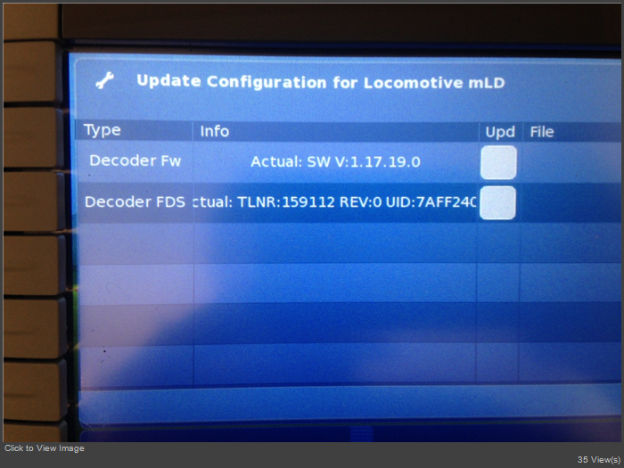

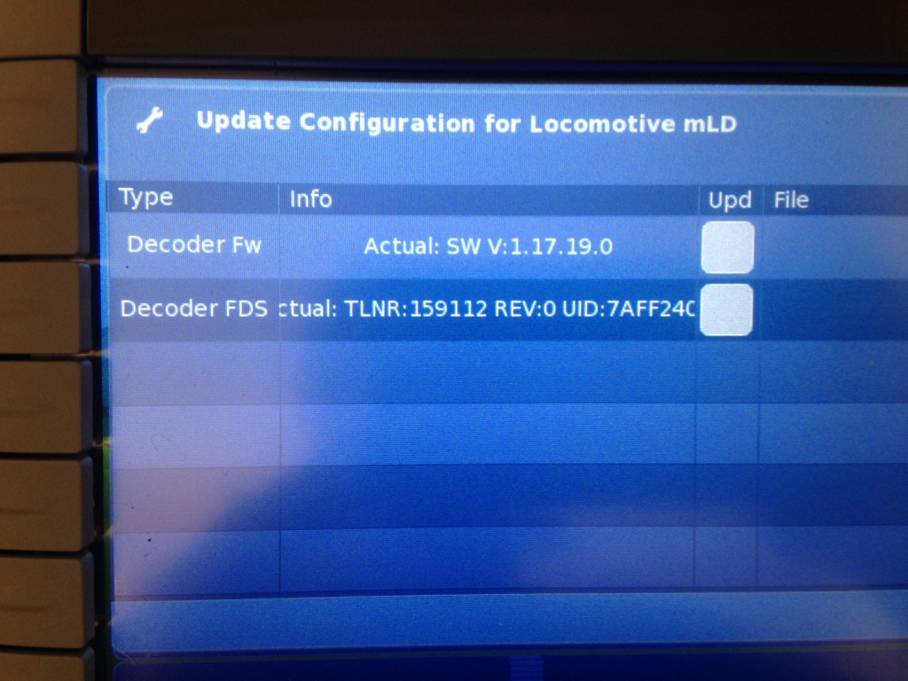

Now that is interesting, when I put my Eurotrain T3 loco on the track and turned on the track power it proceeded to run off in reverse. I assumed it was related to being taken off the track when it was still running during factory testing. Now it looks like it could be a firmware bug in the decoder. But this loco didn't start shipping from the factory until December, so it looks like the decoder probably wasn't updated before being set up for the loco Blink Blink Blink
I'll have to see if I can get the cs2 to tell me what firmware revision the decoder does have.
Just tried it on my Eurotrain T3, and the decoder firmware is level 3.0.1.12. I don't think there could be any facility for updating decoder firmware on the production line, so the decoder will have the firmware that was current when it was manufactured (wherever that is!). Probably this was a long time before the loco was assembled.
Interestingly, though, I could update it with the 60971, so my T3 is now at level 3.2.0.3!
Nigel
Thanks Nigel for doing the investigation. I figured what you are saying is probably the case - there is often a lot of stuff around that comes out with a lower level of software than the 'current' one.
I did think they may have done a software update as a standard part of loading the sound files, but I guess even that happens far enough ahead of all the bits being assembled that it still wouldn't have received the September update.
Yes, most new decoders (if not all of them) are the same hardware as the retrofit decoders (mLD3/mSD3). Updateable, but sound locked. I think this is a great improvement over the earlier "decoder lottery".

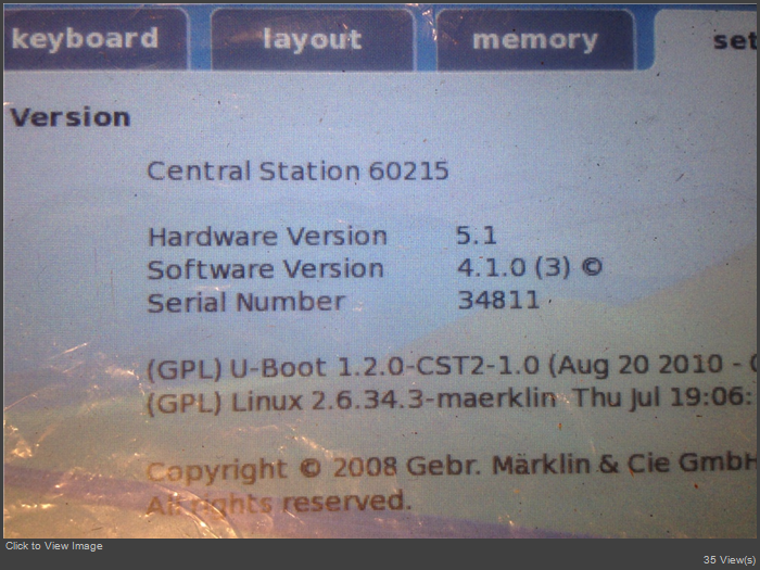

FWIW, confirming that a refresh of the CS2 shows 3.2.0.3 for ALL previous known decoders AND adds the same level for
P/N 249245 (same family as 1-Guage -245)
-239 = G Series
-240 = G RetroFit
P/N 327196 as a new appearance for HO 64Mb mSD/3 NON retrofit
-245 = HO Series
-247 = HO Series (GamesWorld)

Early adopters of the recent main CS2 update 4.3.2(8) will have received a regressive 3.0.1.8 decoder library.
since then the 3.2.0.3 library has again been made available

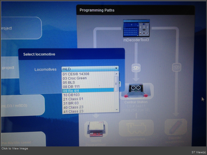

Well, I decided to have a go at updating the decoders in my various locos today, but first a bit of preamble ...
The MRR Club I go to had an exhibition a couple of weeks ago and decided to have an open day at the club rooms today to try and entice prospective members who had been to the exhibition to join the club.
So I decided a useful activity to do while there was to update my decoders to current software levels.
It proved to be an interesting exercise with a couple of unexpected results - one of them caused me to raise my eyebrows a bit and wonder what is happening ...
I started with my T3 Photo livery (as in my avatar picture), which echoed Nigels experience above,
Then I did both my Br65 locos, the 39650 Marklin one which arrived late last year had version 3.0.1.12 software, same as the T3. That updated happily. The 22650 Trix one which finally arrived about a week ago had version 3.0.1.11 Confused but both happily updated to 3.2.0.3.
Next attempt was the 39952 VT95 Railbus with trailer which had been back to Marklin f or repairafter it burnt out something and wouldn't work any more. This had a decoder with version 3.1.0.1 software and happily updated to 3.2.0.3 also. However getting the decoder out to put it on the programmer was a real pain - the instructions are not clear - and there is a gotcha which I managed to work around, but does produce a question which I will deal with at the end.
Next loco to try was my 39567 Insider Rangierlok Crocodile. The decoder in this has version 3.0.1.12 software - and refused to updateScared Scared Scared OhMyGod Confused Confused Confused I presume this is due to special functionality in there to deal with the new Telex uncoupler, but the new Kof in blue/cream livery seems to use the same Telex, and I would have thought the more recent revision of software would have had this functionality as a matter of course.
The last loco I attempted was the 39170 Insider Br103. this reported revision 3.0.1.8 and also would not update. Now this loco is a bit older, and I am wondering of it is an msd instead of msd/3 decoder, which would explain why it wouldn't want to update.
So now to my question arising from the 39952 Railbus update. The mdt software shows being connected to a cs as an option. Will it update the software in the loco working this way? I presume the connection is made by network and operates on whatever is on the programming track. This was my first attempt at using the mdt software (and I hadn't read the manual, but it seemed reasonably intuitive to use) and I didn't have means handy to connect the PC to the cs2 to try this. But it would have saved some hassle with the 39952 - the instructions for dismantling this to get at the innards have no pictures and don't point out that a critical screw that you need to remove has a Torx head and I didn't have any Torx drivers with me let alone very small ones. Why they could have used one of their normal screws is anyone's guess Angry Glare Glare Glare
Speaking of which, why do they sometimes use straight blade screws instead of cross point ones for holding the body on? Typically done in an awkward place where the screw driver slips off easily!!!Angry
My only gripe with the mdt software is that it doesn't tell you if the decoder is an mld, msd, mld/3 or msd/3 when identifying it. The only info you get is it is 'not a retrofit decoder'.

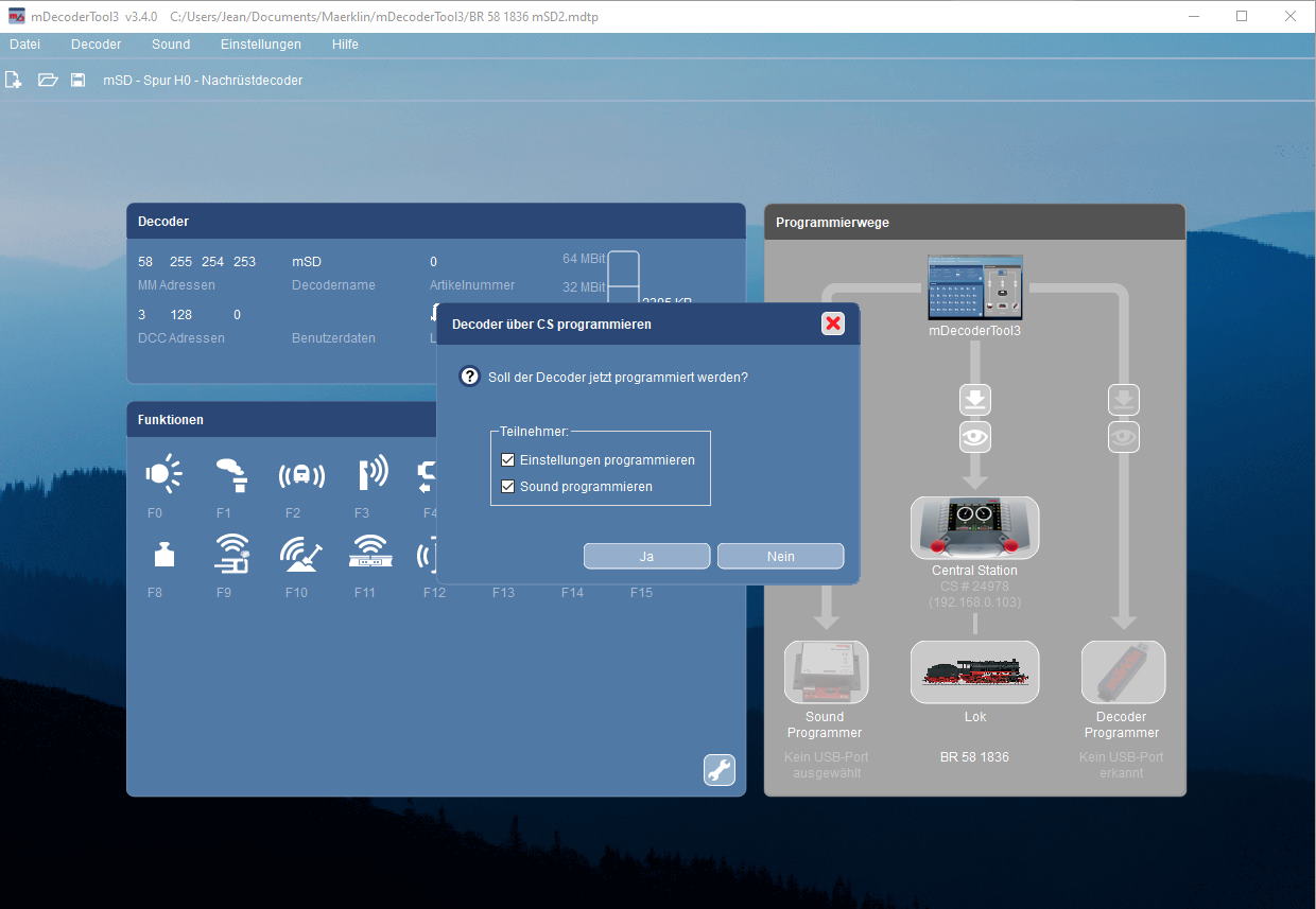

During this Corona isolation I have tried to use mDecoder tool 3.4 ( latest version ) with my PC trying to use CS3Plus, but I have not figured how I can make decoder tool to see CS3Plus.
Tool see the USB stick 60971 and works fine, but when My Pc is connected to network and CS3Plus is connected to network and I start mDecoder tool 3.4 in my Pc it won't see running CS3Plöus which have the latest firmware and all software.
Please can anybody tell me how I could make these two to see each other and I could make decoder programming through the network from my PC to the loco staying on the programming track.
I hope someone can help me

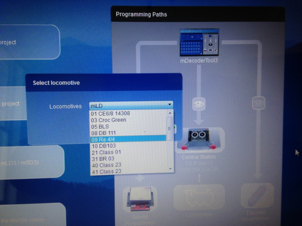

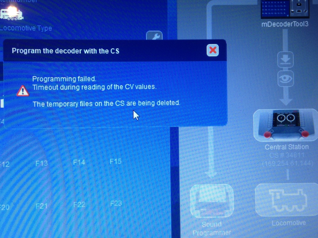

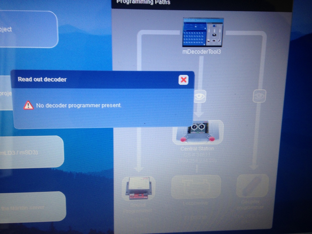

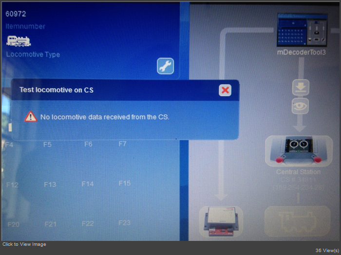

I am also having difficulty with the Mdecoder Tool and I would be delighted if someone could assist me to get this to work.
I feel that I am nearly there, but just not quite there !!
For information :
Hardware is CS2 60215 hardware version 5.1 and software version 4.1.0(3)
My PC is connected directly to my CS2 with a broadband cable, and CS2 is connected to Programming track.
My mLD3 decoder is in a loco on the programming track. My loco software is SW 1.17.19

Problem
My problem is that the programming of the loco fails.
PC cannot write to the loco. It times out during reading of the CV values.
The main issue which I can see is that the Mdecoder Tool cannot recognise the loco.
The loco is 'greyed out' in the box where it should be displayed.
If I compare my pictures with the pictures from other users then I can see that they have the loco picture displayed in the Mdecoder Tool.
Obviously there is some connection taking place on my system because it asks me which loco is on the programming track, and I can select it from a drop down box with my locos listed, but it does not show up in the box.
I wonder whether there is anything in the CS2 comms screen which I need to adjust ?

I have also had some difficulties using the mDecoderTool3. Here is my check list:
- mDecoderTool3 must be at the last version (v3.4.0) otherwide it will propose to update it.
- the CSx (2 or 3) must be coldstarted with a blank memory stick ALREADY plugged in it.
- the CSx is with the loco to program on the connected program track with POWER ON, the loco is stopped and no sound.
- the mDecoderTool3 is started and the PC is connected to the CSx by an Ethernet cable
- now the CSx appears on the screen
- press the loco symbol on the screen
If no loco is displayed like this
then you have to re-boot the CSx while the Ethernet cable is connected
Otherwise you have a drop down list of locos
Once you have selected the loco, its icon is displayed (bottom of screen)

Now all this must be made while a valid project has been selected (It should have been from the start)
Note that the arrow to start programming is now there just above the "eye" key.
Once pushed, a programming confirmation is asked and a question is asked with / without Sounds?
Now confirming will start the programming phase starting with the transfer of 4 files
ATTENTION When the programming is finished you must select reset to finish the programming (failure to do it will cancel the programming.
NOTE: Märklin proposes to download a new version 3.4.1 but when doing so, nothing is dowloaded so for now we stay with V 3.4.0
I hope this helps

For information :
Can you please provide more information about your decoder ?
is it an original Märklin installed decoder ore a refit one ?
the decoder SW 1.17.19 indicates a mld decoder of sorts. mLD3 decoder firmware should start with version 3.xx

I get the CS2 to show in the Mdecoder screen, and it has the correct router IP address and serial number of the CS2.
I get to see the locomotive list in the drop down box and select the loco on the programming track, as you showed, so the CS is communicating with the PC.
I get to test drive the loco from the PC, and lights and speed control, reverse, all operate with the loco on the programming track, also reflecting the same on the CS2 controls, so the PC can send instructions to the programming track.
I can load a project and see the functions on the Mdecoder Tool.
All of that works.
The only thing is that after selecting the loco from the drop down box, the loco box remains 'greyed out' and there is no picture of the loco, as in your picture.
For some reason, the error message says "No locomotive data received from the Central Station".
May I ask you : which CS hardware and software versions are you running ?
My 60215 is probably 6 years old, and I have actually not updated the software since I purchased it.
Was there possibly a CS2 software bug fix to correct the above issue ?
I am running the Mdecoder Tool software v3.4.0
RegardsBigGrin
Hello
The two locomotives which I am trying at the moment are Marklin 60962 (Locomotive Decoder) and Marklin 60946 (Diesel Sound Decoder).
Slightly dated from 2011 and 2012, but very much Marklin items.
They both have the same result :
I can operate all the functions (sound and lights and speed) of the loco on the programming track from the PC Mdecoder software through the CS2,

When I try to do a Decoder Readout, the Mdecoder Tool is trying to read from a Decoder Programmer,
but I don't have a Decoder Programmer.
I want to use my CS2 for the programming.
Is there an option somewhere for me to set programming on the CS2 and not on the Decoder Programmer ?
Regards,BigGrin

Posts: 1,307
- Improvement: Decoder (mLD/mSD, mLD3/mSD3) programmed and tested via central CS2 from v4.2.9
on revised, improved and optimized
My CS2 software is 4.1.0(3).
I suppose that this could be the problem.
I should probably do a software update and then try again.
RegardsBigGrin

Sorry, I misunderstand you the first time, I assumed it was a factory decoder because of the sw version.
bet be aware tat it's an mLD/mSD and not a gen 3 decoder. Have you started with the corected template in the Mdecoder Tool ?
you can not read out a decoder wit an CS2/3 but you should be able to program the decoders. ( i have no problems programming with my CS3)
I do however recommend that you upgrade to the latest software on your CS, if you have problems.

Just to let you know that I have now achieved success with the problem which I was having.
I update my CS2 software to v4.2.9 and now the Mdecoder Tool reads the loco information from the CS2.
The 'greyed out' box is now full, there is a picture there !
Now for the next steps ...
My CS Hardware is 60215, version 3.81, hardware version 5.1, Software version 4.2.9 (0)
My mDecoderTool3 is also v3.4.0 (the last one)
If the loco is not shown it may mean it is not registered or without power. (the decoder provides no response to the query sent by the mDecodrtool3 (IMO)

Do you mean the one in the CS2 where the CVs are updated ?
There are some buttons there, Reset , Sound, Update , etc, I can't remember them all now.

Here is a video on how to update de firmware of a decoder (outside of mDecoderTool3)
It seems akward you have to do this BEFORE using the mDecoderTool3 but it is so.
Hi Jean
Where is the 'Reset' button ?
Is it on the PC or is it on the CS2 ?
It is with the mDecoderTool3. The main message is: when the programming is finished, don't remove your loco just yet but wait until the decoder reset is done. It is not one to factory values but one to confirm the new programming.
