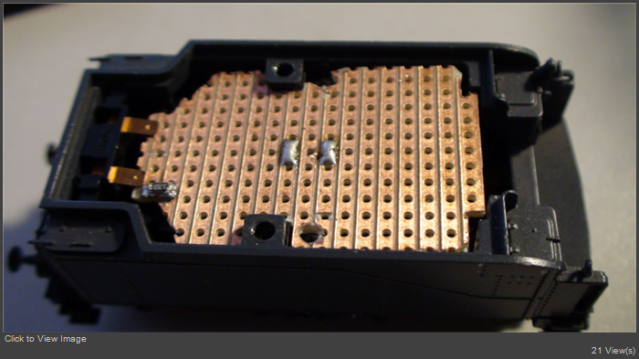

Watch this space, I'm in the progress of converting mine to digital with an ESU sound decoder, I've already made up a circuit board by replacing the original one, the slider holder I've de-soldered it from the original board and soldered it onto the board. I''be using an 8 pin ESU sound decoder but will remove the 8 pin plug, shorten the wires and solder them onto the new board. I also be looking at the steam generator and side rods gear lights.
unfortunately when I drilled the hole I've hand drilled it afterwards to make it slightly larger and broke the corner off but it doesn't affect the tightness when screwing it down., as you can see the round 23mm loudspeaker fits nicely, just into its place and also the ESU sound decoder has plenty of room., the wires I'll be using will be insulated copper wire (12) they are easier to bend and stay in position, they will be fed through the underside of the circuit board and soldered on top.
thanks 5 users liked this useful post by river6109
