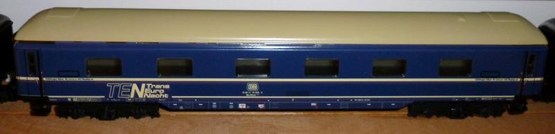

Hello, I need help identifying a blue TEN passenger wagon model number. I am not able to find this model in the catalogs that I have access to. Any help is appreciated.

This is a PRIMEX #4010. Made between 1985 and 1989.

Markus,
Without the roof, how can you tell whether this is a Primex 4010 or Maerklin 4130?
The 4130 had a blue roof. The Primex 4010 had an ivory roof.
I'm leaning towards the 4130 for the following reasons:
1) the model in the photo is equipped with trucks with mounted buffers
2) The model in the photo has red taillights painted on the coach ends
AFAIR, the Primex version was a basic model that came with trucks that did not include the buffers
nor did the Primex version have the red lights as painted details on the coach ends.
Primex 4010: https://assets.catawiki....d3-aaa1-1286989a241e.jpg
Maerklin 4130: https://www.bimmelbahn24...mh-der-db-blech-ovp-top/

Markus,
Marklin is impressed in the floor tin plate. I dont have the original roof.

Both the Maerklin and Primex Models bore the Maerklin, Made in Germany markings on the bottom.
You may be able to obtain the roof part from Maerklin as it was used in the retooled 0766-04 DSG model. The only issue is that the roof has a different colour.
You could check with APC-Adams or Ritter Restaurationen, but by my calculation, it might just be cheaper to source a complete model on ebay for 15-30 EUR.

Markus,
The positioning of the TEN lettering on the sides would also lead to the same conclusion.
#7 Posted : 07 October 2018 14:55:32(UTC)
Posts: 31,709
It is Marklin 4130 - 'TEN' letting on left side and 'TEN' right on other side.
Primex - 'TEN' left on both side of 4010.
First image marklin version and 2nd image Primex. Note see the red circle.
