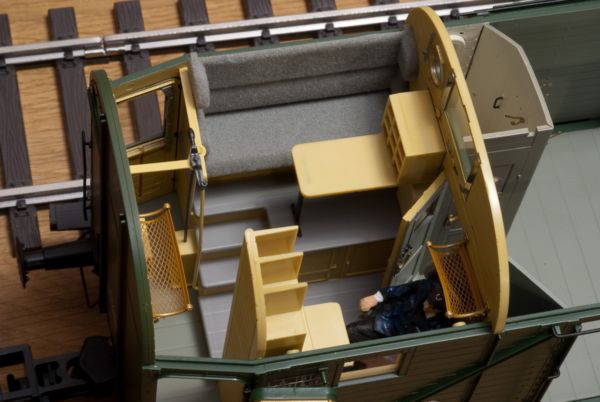

The Maerklin 1 Gauge Model:
A look at Maerklins’ I Gauge model shows why it interests me. Magnificent interior modelling is a feature of models 58117 and 58118. The photo below shows the look-out raised roof office compartment (in German the Zugführerabteil) with seating and work table for the train-director (in German the Zugführer).

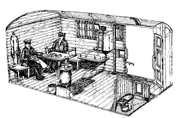

The crate/baggage storage area also included a wood stove and a toilet as shown in the artists drawing below, and these are included in the Märklin 1 gauge models.
