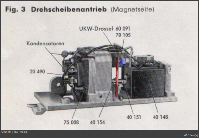

I am travelling for my business so I won't be able to try this, but from my memory, I am not sure which screw is blue - could you please identify which one that is from the posted photo?

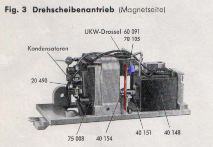

Look at the photo: I coloured two parts in blue and red to identify them. The part 78105 is blue. In reality the parts are not coloured.
