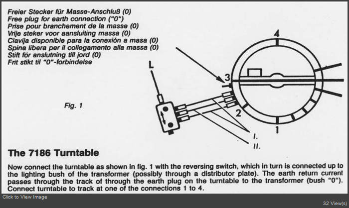

Thanks for that. I eventually found the problem, the turntable must be connected to one of the four tracks as shown in the attached diagram.
I found it online, the booklet that came with my 410 did not show this.

Thanks for post, glad I did search, having same issue on my 410.
