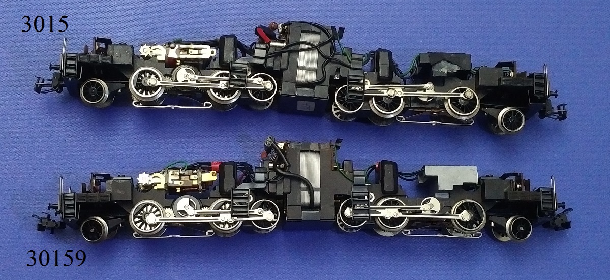

On the pictures attached you´ll see the small differences in the switches.
The 3015 shown has the switch 208660. This version of the switch was used until the late 1960s. Later 3015 in 1970s have the same switch 234000 as shown in the 30159.
