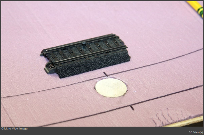

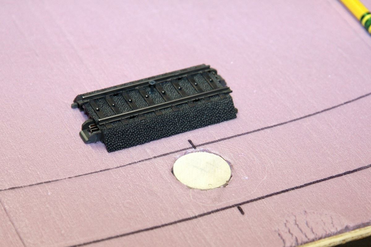

I'm laying my C-track directly on pink insulation board. I sink a 1" dowel every so often to secure the track. I use a 7/8" paddle bit to drill into the foam. Works well for me....
