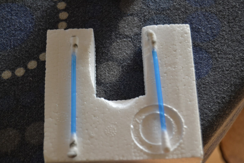

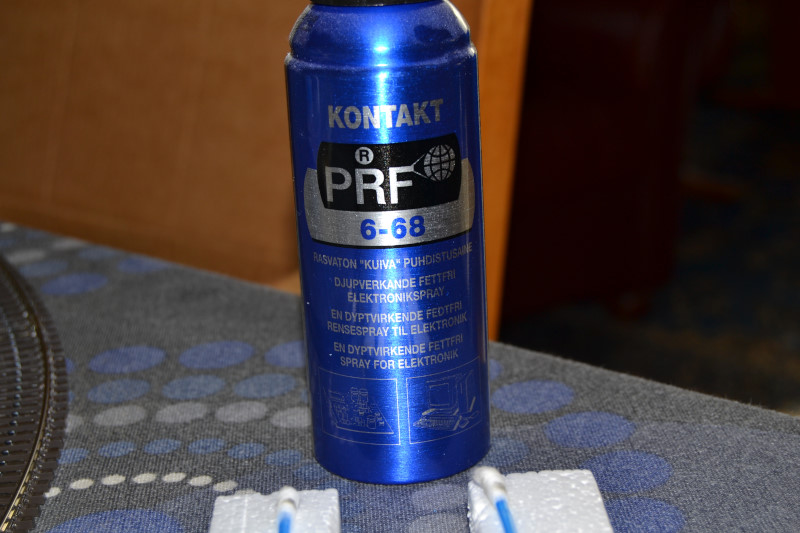

I use cotton top and deep clean fat free spray for the electronic.
Notice the dirt on the cotton top after i did cleaned my K tracks.
