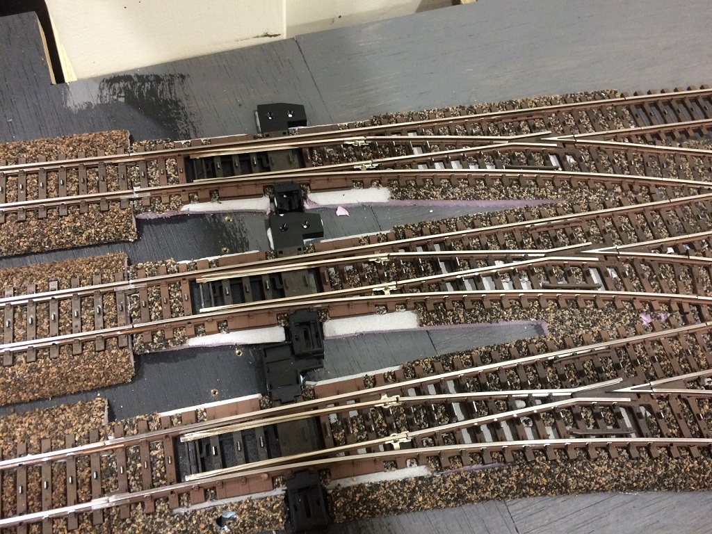

Lack of options with turnouts. Those who already have 3 rail locomotives but are serious modellers use other track, such as Tilig Elite, and then installed pukos/relays in them.
This is because Tilig Elite has much wider radius turnouts (including double slip) and code 83 rails (correct height) and the sleepers look better too.
As already mentioned, K track does not have wide radius curved points at all.
There is also the fact the Marklin tracks all have their turnout tongue mechanism set back from the front to allow the spring return of the rail when driving the wrong way.
This has functional benefits but means the turnout mechanism and lantern are in the wrong place. It doesn't look so bad on the wide radius (2271X) turnouts but looks quite wrong on the narrow (226X)
It is also an extra point of failure because the servos/solenoids are not directly driving the tongue. I've had issues with this myself where the mechanism moves but the tongue doesn't.
K track can still be made to look great and work great and is a lot better for an authentic layout than C track though but not as good as 2 rail (or 2 rail with pukos).

I just want to mention also that I have had a couple of turnouts have issue with the merkur roadbed.
Given that there is a lot of missing ballast on the turnouts that is unnecessary, I feel its better to hand ballast K track turnouts.
Merkur for standard track pieces is good though - in particular for flex track because while it is hard to bend to shape, it holds its shape afterwards with the flex.
edit: I feel I need to update this post because I since concluded that the merkur is not the cause, rather some unknown distortion in the turnout which prevents the linkage from moving the bar/tongue (see below)

I had another turnout play up and I hadn't used merkur at all.
I think just the mechanism design for K track turnouts is crap - for completely unknown reasons some turnouts just don't move the tongue once installed.
I have read that it is related to tension in the track once its connected but I'll be damned if I can figure out exactly where the tension is and why it stops the tongue moving.
As a result it is best practice to not solder K track turnout pieces as there is a chance once they're installed suddenly the tongue decides it won't move and you need to remove it again.
#26 Posted : 09 February 2018 09:38:46(UTC)
Posts: 2,297

Hi Dale,
I think you have mis-understood where the mechanism is failing. When I say tongue, I am referring to the track itself and not the slot mechanism.
What happens is the mechanism is connected and moves fine and the thin plastic connector that goes from the mechanism to the front of the switch and connects to the track tongue moves, but the track piece itself does not move. Ie. there is friction or something else that is stopping the track tonue from moving to switch from straight/curved.
I have had 2 turnouts with this issue and it has been a massive timesink to try and resolve. They work fine when the turnout is by itself but once laid and connected on the layout it stops.
The first time it happened I ended up resolving it by completely removing the turnout and putting it back in. Worked great and I installed and tested the servo and lanterns etc.

Hi Eric,
Yes, you're exactly correct this is the bane of the K track turnouts and I could not have said it any better!
Your explanation says it all and that is what killed my fondness for the K track turnouts on my layout. It happened so frequently that I could not take it anymore and it was causing me to grind my teeth when I had trains running as I could not depend on the turnouts to throw due to this design flaw!
I've switched most of my layout to C track turnouts and track to have 110 percent reliability at all times. ThumpUp ThumpUp ThumpUp

Sounds like a man who has suffered more than I have! It would have been quite a lot of work changing over to C track.
Unfortunately C track has different geometry than K track d I am not in a position to change them over - C track also doesn't work with servos and the fixed position lanterns would not work for me, also there is the problem of the fixed ballast on C track where my K track yard is all laid flat.
If there is no real solution to the trouble turnouts, my other option is to remove the mechanism completely and connect the servo to the tongue bar itself (like all the other manufacturers)
This would be difficult to do (I would have to remove the turnout) and would make my lanterns static though.
This sounds like you have the original slim turnouts with the moving frog. These were always a problem as any ballast grit or fluff or other dirt that got under the track was enough to jam the mechanism that moved the frog.
No, I do not. These are all new 22715/6 turnouts less than a year old. I am well aware of the issues with the moveable frog but unfortunately there are still issues with the mechanism.

What about the possibility that the turnouts are getting twisted as you tighten or glue them down? If the things get twisted I imagine they can bind. Could be the benchwork twisting due to
Conditions?
The turnouts are not tightened or glued down. They just sit connected on the layout.
There must of course be a reason and I do believe it is a twisting or tension issue - however the tolerances for failure are so small it makes it impossible to identify and rectify.
One of the turnouts that has failed is the top one in this picture. Yet the other two directly below work perfectly!
If there was a distortion in any way it should affect all the turnouts.
The one that was failed had played up once before and was only resolved after I removed it and put it back in and it worked perfectly until I went to use it many months later and now... dead.
Conditions?
Maybe you explained this somewhere else, but what are the turnouts sitting on? I can't identify what the white material is.
I mount all of mine on cork and after 4 years I have not experienced the problem you are indicating. I bought one once on eBay that after a few weeks wouldn't move and upon closer inspection I realized that one of the linkages had been glued together previously and the glue broke off. So that was just a broken one that someone passed on to me.
I'm just wondering if the white material yours are sitting on expands and contracts unevenly which could twist the switch and linkages.

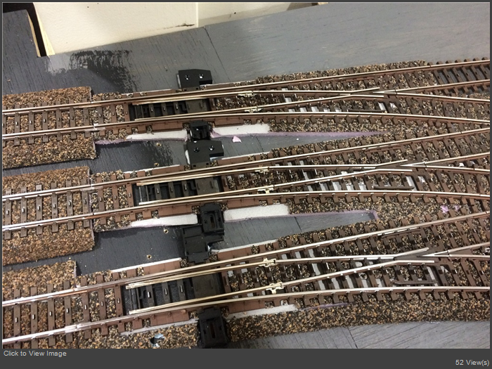

The real issue with the Marklin K track turnout(s) are revealed and uncovered for the first time and you'll read it here on the Marklin-users.net forum!
I'm not grasping for straws as I have the proof as one of our past prime ministers has said, ”"A proof is a proof. What kind of a proof? It's a proof. A proof is a proof. And when you have a good proof, it's because it's proven." - Jean Chretien.
Or
It could be the fickle finger of fate, an unseen and unforseeable force that controls the direction of all living things. Oops, almost right but........
Actually it is the fickle finger of the Marklin K track turnout! Check out my picture and you'll get a close up of the bloody thingy that's causing this grief! It's weak and flexes when it shouldn't causing endless grief!
I see that you seem to be using underground adapter sets.
Those are notoriously iunstable and WEAKENS the power of the throw greatly.
Before signing the death-certificate of said switch, you might try with a drive connected directly to the switch.
Also, the different lanterns and underground adapter-sets seems to be overlapping on the photo. That could also have an influence.
I know that the drives might disturbe the visual aspect, but in dense areas, you might want to leave some of them on the top, just to preserve funcionality. (I mean; what is even the most beautiful layout worth, if it doesnt work properly?)
Alcually, sometimes the drives can be installed up-side-down, (turning it around 180º) and covered with ballast you would hardly notice it.
I can only add my own experience, and those are 0 failures in 10-12 years. (Failures of the type you mention here, I have had other problems though...)
I install the drives on top, with the ugliness that it implies.
I bridge the end-cut-off switches with a solder blob, and power the relay with 24Vdc.

applor
Joined: 21/05/2004(UTC)
Posts: 1,805
Just grasping at straws here as I've got no real k track other than 2 m flex to test the c-k-c transition.
Could it be the rails that feed into the switch that is twisting and this twisting the switch itself?
Just wild guessing.
I think you are on the money for what can be the cause - I believe some sort of rail twisting is causing the tongue issue with a different turnout in my layout.
If the is a twist though it is not perceptible and goes back to my complaints as to how fragile the mechanism is.
It is Merkur roadbed. It is a hard foam underbed rather than cork:
http://www.merkur-styroplast.de/
Henrik,
You have not read my post properly, I have already stated clearly that I am using servos and that the actuator mechanism has no problems and moves easily.
The lantern install was a custom fabrication to fit them and as stated, there is no problems with the actuator mechanism and so is not related to the issue.
Offline applor
#49 Posted : 12 February 2018 22:44:51(UTC)
applor
Posts: 1,805
I agree with Henrik that I certainly have had issues with the K track switches, but not the issue described by Applor or michelvr. In my opinion if the linkage does not move it is either broken, restricted by something between the linkage and the roadbed, slight twist of the switch due to a non-flat mounting, or a misalignment of the actuator mechanism for either the manual lever, the solenoid actuator, or the lantern. I have had switches that worked normally until I added the lantern.
The actuator works fine, the problem is the linkage only moves at the actuator end and does not throw the tongue.
The linkage is not broken or obstructed which would leave a slight twist of the switch - which I am unable to observe. It goes back to the root of the problem in that the design is inherently poor and so fails even when a switch would appear to be laid flat and true.
I have my suspicions that the linkage itself is fine, rather there is force being applied to the tongue causing friction to prevent the tongue moving.
I have taken a photo and circled what could be the cause.
It is also quite likely related to the throw bar.
Perhaps I need to take a video of the issue? A number of people are misunderstanding me - it seems Michel is the only one so far who knows exactly what I am talking about and experienced the same issue.
#50 Posted : 12 February 2018 23:40:30(UTC)
Posts: 4,048
hmm I see. Does the servo perhaps actuate it slowly? The Märklin switch motors snap across and that may be the difference.
My k-track 'floats' somewhat in the Merkur, with no screws or nails holding it down other than the electrical wires. I have never had this problem.
