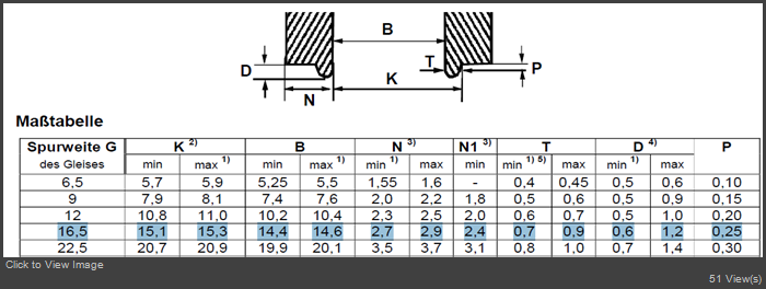

#20 Posted : 05 December 2017 20:09:47(UTC)
Posts: 2,323
Yeah, its unfortunate that H0 is not the same as H0.
NEM 310 H0:
NEM 340 H0 (Systemen MÄRKLIN):
#21 Posted : 05 December 2017 22:03:21(UTC)
Posts: 4,049
NEM 310 H0:
Very interesting, I was not aware that Märklin had their own NEM for HO! But this does explain why watching Märklin related train fora for decades, has taught me that almost every long thread about derailments on Märklin track eventually resolved to people using non-Märklin wheels or couplers!
I run only Märklin stock on Märklin K-track and do not have ongoing derailment and coupler failures.
Visitors have run stock from other manufacturers on my layout, mostly successfully too.
#22 Posted : 05 December 2017 22:50:47(UTC)
Posts: 15,552
NEM 340 documents what the world-market leader is producing.
NEM 310 defines what the other manufacturers should do to reach compatibility.
Derailments on Märklin track are usually caused by incorrect wheel sets - or by Märklin short couplers colliding with non-Märklin scale models.

#24 Posted : 05 December 2017 23:46:44(UTC)
Posts: 2,323
From what the NEM documents say, I read them as
NEM310 - the wheel set standard that considers the NRMA standards, for use on NEM 110 track.
NEM340 - deviations from NEM 110/310 for wheels and track for Märklin systems in consideration of central conductor pickup.
So I'd say the 310 is the standard companies should target for inter-operation, and 340 is the deviation from that standard that the Märklin systems are using and what manufacturers should use to work on Märklin systems.
