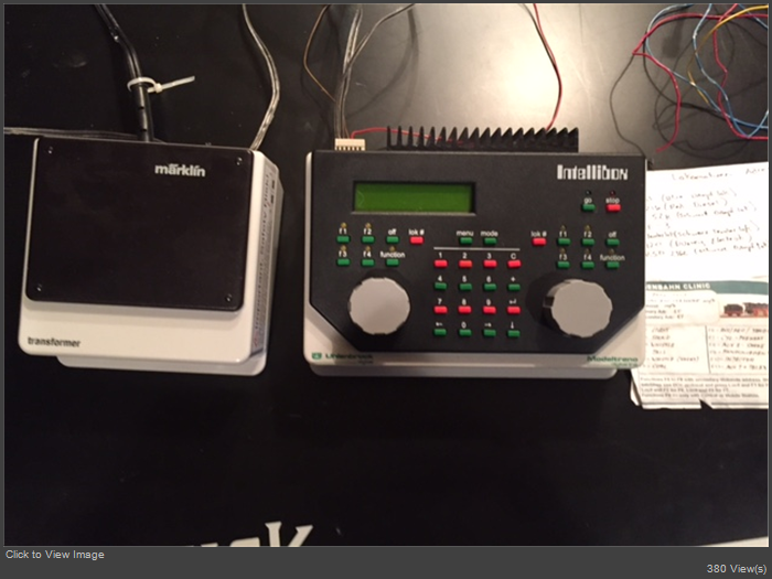

Thank you for the help Tom. I tried address' 3, 255 and 52. I didn't have any luck in getting the additional functions to operate. It's not a big deal to me right now. It's the only locomotive I have that has more than nine functions.
Currently this decoder is assigned two addresses. 50 and 51. And the functions I want are all accessible except for the Telex coupler. I am going to try to reprogram a couple of the functions with thre Intelibox and see how that goes.
The most important part right now, is that I am learning the capabilities and how to use the Intelibox.

OK, I'm just a little confused. Currently this Locomotive has two addresses. 50 (primary) and 51 (secondary).
The decoder listed on the Functions sheet is a ESU Loksound mfx decoder.
so on this list, I can access F-0 through F-8 with the two assigned adresses (50 & 51).
I'm wondering if I can remove one of the functions (F5-F8) on the secondary address and replace it with AUx2 - Telex coupler.
I will check the CV 7 value and see what it is set at.
I can access the programming mode on the Intelibox and read the CV's. I just need to spend some more time on it.

Thanks River6109 & HO,
So far I have learned quite a bit about the Intelibox. I had forgotten a lot over the years. But I am not able to access any of the CV values on the Lok with the Mfx decoder. I just keep getting an error code. Same thing when I tried the programming instructions that HO posted a link to above in post #__.
I believe my next step is to update to software version of my Intelibox. I am running version 1.300. I believe this software version is prior to the Mfx decoder. But I'm not sure on that.
I can access all the CV values of the BR52 Locomotive with the LokSound2 decoder but am not able to access anything on the Locomotive with the Mfx decoder, yet BigGrin
