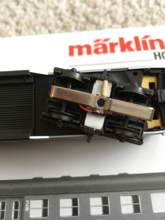

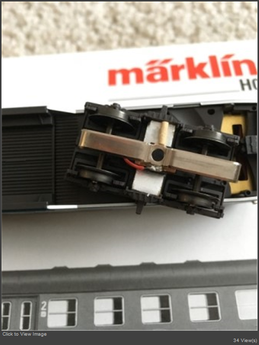

Got the 42152 Swiss two coach set. Trying to fit lighting (done dozens of times) Using slider 73406. For some reason this causes a short. Tested slider etc on track but not on coach and light bar and all works. Coach is fine on layout without slider in place.
I can only think slider might be touching the wheel set but cant see how. Tried with another slider 73406 and just the same.
ON fitting the larger size slider it appears to be OK but of course is too close to coupling socket.
Have fitted all sorts of coaches with lighting I have no idea what is going wrong and would be grateful for any help.

I had a similar problem with the 41322 set that I had bought new from factory. During the first trial, the asymmetrical slider on this set was making a very loud rattling noise and causing shorts when passing on slim turnouts. I tried to replace it (even if it was brand new), but with no success.
In my case, I did notice that the fitting of the slider to the coach is not tight enough. The slider slightly rotates in the fitting when the coach is moving and this is enough to cause shorts on turnouts (and also the rattling noise). I don't know if this is a specific problem to my set or just poor design tolerances by Marklin.
The workaround I used was to place two small blocks of heavy insulation foam on either side of the slider and lock the slider laterally with a small piece of wood inserted between the sides of the slider and the bogie, which I glued on top of the block (see the picture - you can still see the marks left by the studs on the slider from the initial test, they are clearly not parallel to the side of it).
It did solve my problem and the noise is back to normal. Not very satisfactory for a brand new set, but I did not want to send it back to the seller.

Alain.Many thanks for your reply. I do think that the problem I have is exactly as you describe. I will try to sort it as you say or tighten the slider to ensure it does not move. This is the first time I have noticed this on a coach and it would be interesting to learn if any others have found the same problem.
Many thanks again for excellent information.
