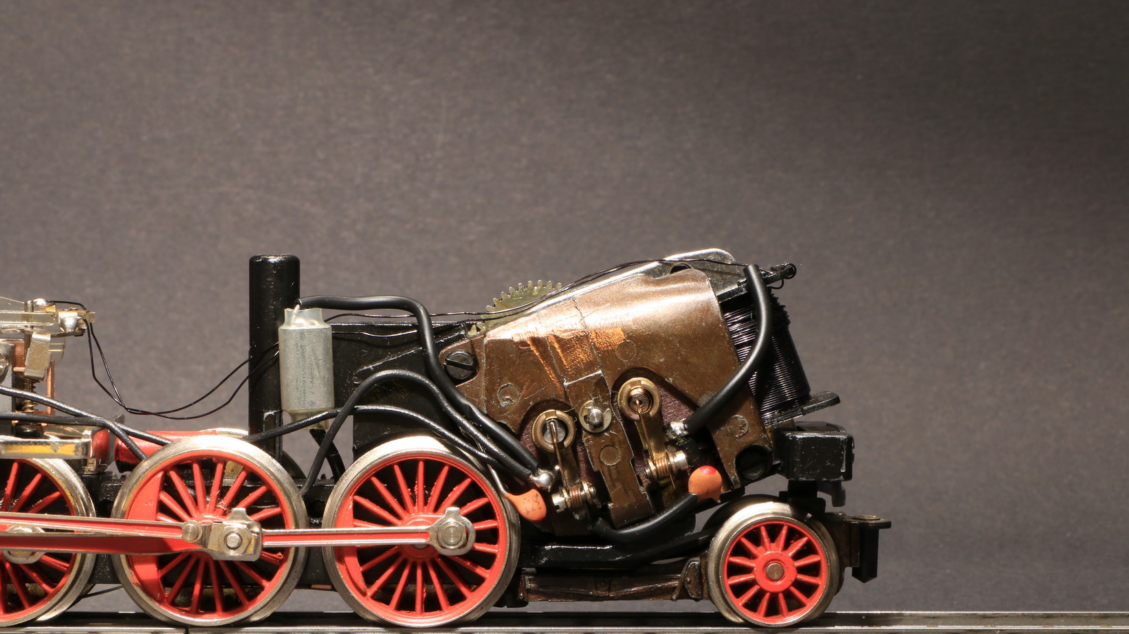

I want to convert a 3084 Marklin using the ESU 51960 magnet and an mSD3 or mLD3 Marklin decoder because the 60944 motor does not fit to the Loco.
Any experience??
Thanks in advance
Costas

Sorry to all of you and thanks for your response.
But SORRY the Loco is the 3048 BR 01 and not the 3084 misstypimg
The motor is a LFCM with special cover so the 60944 motor does not fit
Soppy and Thank all of you again !!!!!
Costas
