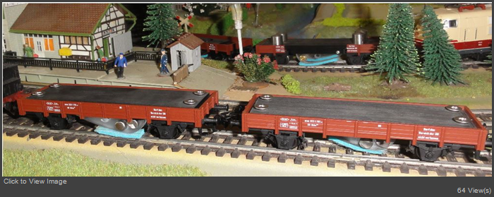

Hi guys Cool
I use as Moritz the item Noch and it is placed under the axle of first coach or freight car behind the loco.
And I have as well as I call the train of cleaning with 1 x 46049 M, 1x 46042 M and 2 cleaners cars Lux and a loco serie 55 SNCB, 37674 M
The set will run when the layout will be ended

Offline TEEWolf
#44 Posted : 22 September 2016 05:31:26(UTC)
Anyone have an opinion on the effectiveness of the 46049
Track Cleaning Car, or alternatively the 15500, or 24050
Track Cleaning Cars?
I use the Märklin 46049 as well as the Trix 24050. But the 15500 is too small for me, because it is gauge N.
In addition I use the cleaning dwarfs from NOCH
Reinigungszwerge NOCH
I always put one piece under a waggon in each train. I am very satiesfied with the cleaning results, although they are expensive, especially by my intensive use. Please be aware about the prices. I found enormous price differences for replacement felts and NOCH dwarfs in the internet.
The felt pads are quickly dirty (probably my air and engines are too dirty Blink ) and then you have to change them very often. So I bought isopropanol to dip the felts and dwarfs into it. I clean themselves in it a little bit, but also use them not dry but wet. The wet felt cleaning results are better as the dry one.
The 46049 and 24050 are same size and for my opinion to fragile for their obligation. So I put additional weight into this little (and they are really too small) waggons. Sometimes I set together a special "cleaning train", but you need a very powerful loco for this train. The resistance and the additional weight is enormous, but the cleaning results too.
