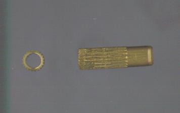

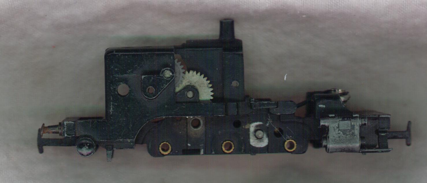

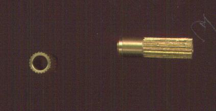

The bushing used to be available as a spare part, I'm not sure if the number has changed but it was 20025. It comes as a solid bushing which you will need to drill/ream out for the axle
Sorry that they are blurry, the forum software resizes them larger than is correct for best viewing....
Here's what it looks like showing the wear that can happen, the two below the motor are most worn from the weight. This will also be aggravated from poor cleaning and lubrication. Remember that oil not only lubricates but should also 'capture' the fine metal filings and draw them away from the wearing surface.

Pulled it apart last night. The rubber tyred axle measured 96 thou and the other 2 measured 98 thou. Bored out the front and rear bushes to 106 thou and the middle one to 103 thou,. That could mean that when I make new axles, the gears might be 3- 6 thou closer together so that wont cause a problem with the wear that is there.. Easier to make and fit new axles than to buy, bore and fit new bushes. It is time consuming though and not worth doing if you have to pay someone to do it. Just another side to my hobby. My bushes didn't look anywhere as bad as the bushes in the picture above.
Dereck
ps Why 2 sizes?? Well, if I stuff up one and go too farCrying , Ii can make it to fit the smaller bush { hopefullyCool } . [ I am only an amateur machinistFlapper ]
