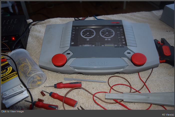

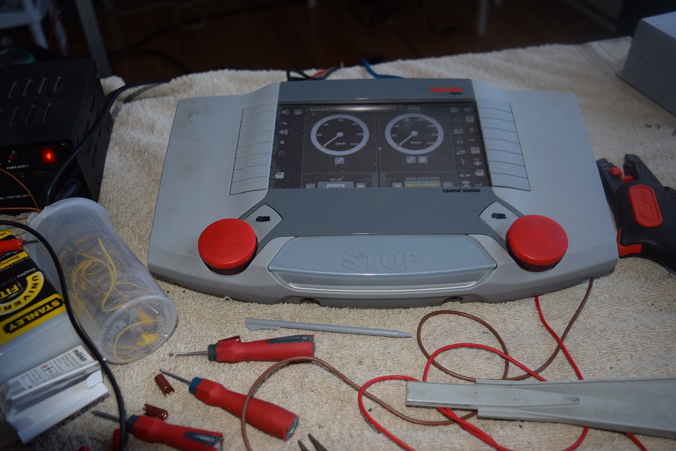

Location: Cowansville, QC
Hi guys Cool
As you will see it by the photos which are going to follow, it is actually a problem on the layout somewhere that causes a short circuit. It is what I believe as most of you

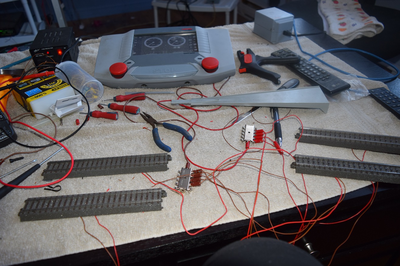

First of all, the exit used of the cs2 is the layout exit.
a) Picture 1 and 2 show the cs2 with the test of red/brown wires-72090. All is connected and all is ok

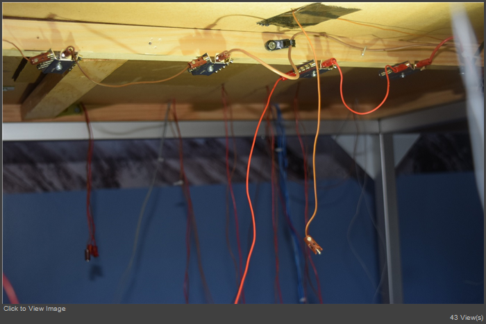

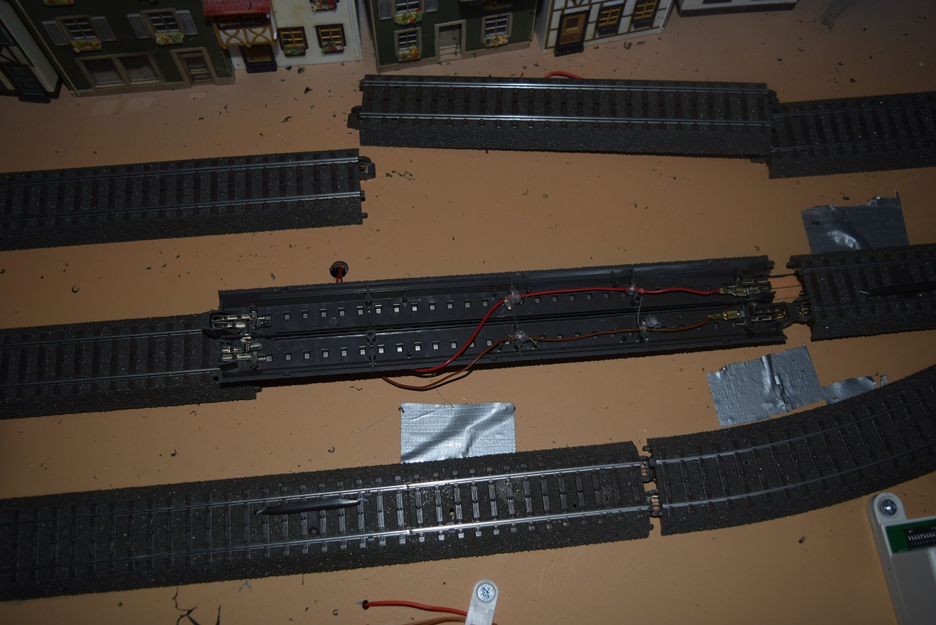

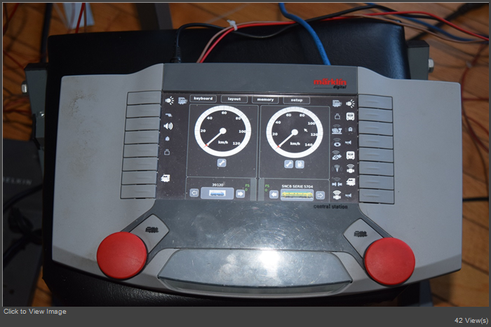

b) Picture 3 and 4 show one track on Heidleberg....the wires red/brown are connected to cs2 by 72090...all is correct and cs2 too

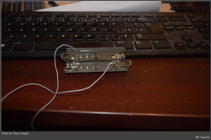

c) Pictures 5 and 6 show the 72090 of Heidelberg

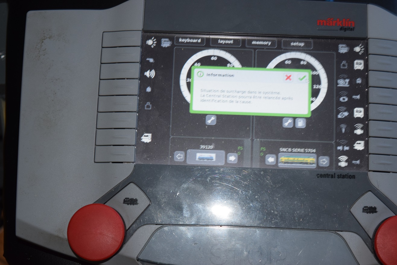

d) The last picture shows the reaction of the cs2.
Here is 5 seconds the track has just been connected to the other tracks of the layout
I am going to verify everything by short sections up to the place where the problem is
Your advice ?

#21 Posted : 14 September 2016 00:35:19(UTC)
Posts: 2,320
Nothing looks unusual. I see there are dangling red and brown wires w connectors in the background. Are those connected to the track loop? The plugs with their set screws may be contacting each other (brown and red) ? Just make sure you account for every conducting wire and component coming into contact with the electrical system of the track.

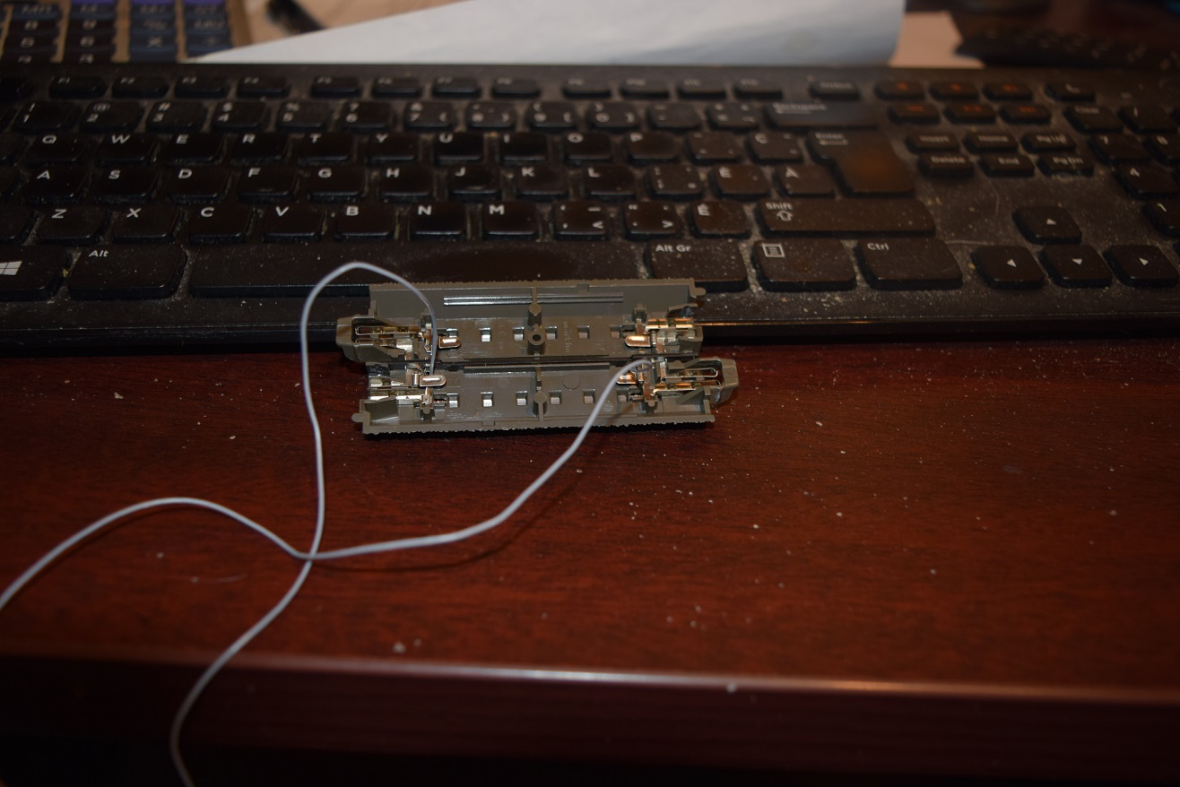

I found the problem: a grey wire of one 7555 affecting one of the borders A or B of a track. Finally I think that it is the reason
This is my fault: to place one 7555 M on one 24077 M... damned Serge.Crying

Offline Thewolf
#27 Posted : 14 September 2016 23:18:15(UTC)
Thewolf
Joined: 08/09/2015(UTC)
Posts: 2,096
Impossible to wait .
I was not able to resist the fact of testing my softwre ''Itrain''
The sound '' clac clac '' of the turn outs are pleasant to hear BigGrin
Thewolf
