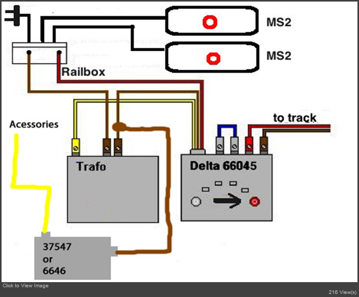

wiring conncetion 1
wiring connection 2
showing in graphics three power connections ( in Dutch: Aansluiten Märklin = wiring diagram or as I write "power connection" or “power to the tracks”). It is a nice overview including also the old connexion with delta control sytem. Also no longer sold by Märklin, but still often used by “older” Märklinisti. (= Märklin fans).
Now I guess, that you got a 24088 for an MS 1, but you "only" have a MS 2 or MS 3. This will never work together. For a MS 2 you must have (no exceptions) as a minimum a digital box (60113 or 60116) for a power connection. The main reasons are a change in the power supplies by a new law and a different technique by Märklin. Märklin had to switch from the “Transformatoren” (transformers) to “Schaltnetzteile” (switching power supplies).

Originally Posted by: akerstdi Go to Quoted Post
P.S. Loks will not register in this configuration. You will need to split off a brown and red and wire them to a separate track before the 66045, and loks will register on that separate track.
Tams Booster Link
There is a Booster Link from Tams. It will enable the auto registration from mfx locos: http://tams-online.de/Pr...tal/Booster/Booster-Link
I guess, it will work with the Delta Control, too.
I may update my circuit plan with Booster Links connected:
Edited by user 13 September 2016 08:22:30(UTC)  | Reason: Not specified

Offline Moritz-BR365
#23 Posted : 13 September 2016 09:16:10(UTC)
Moritz-BR365
Joined: 02/04/2013(UTC)
Posts: 683
MS2 with Delta Booster and TAMS Booster Link, really easy to connect:
Edited by user 13 September 2016 13:20:45(UTC)  | Reason: Not specified
