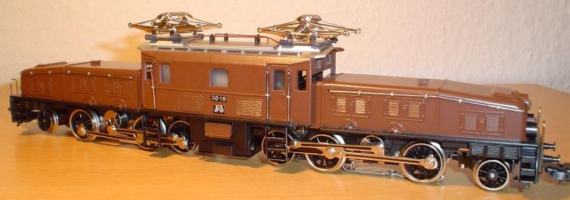

Once you get the taste of Crocs,what about Marklin 30159 (Insider),a brown croc built as the original M croc,with modern electronics:
http://de.academic.ru/pi...7/M%C3%A4rklin-30159.jpg
Nice in its own way.
