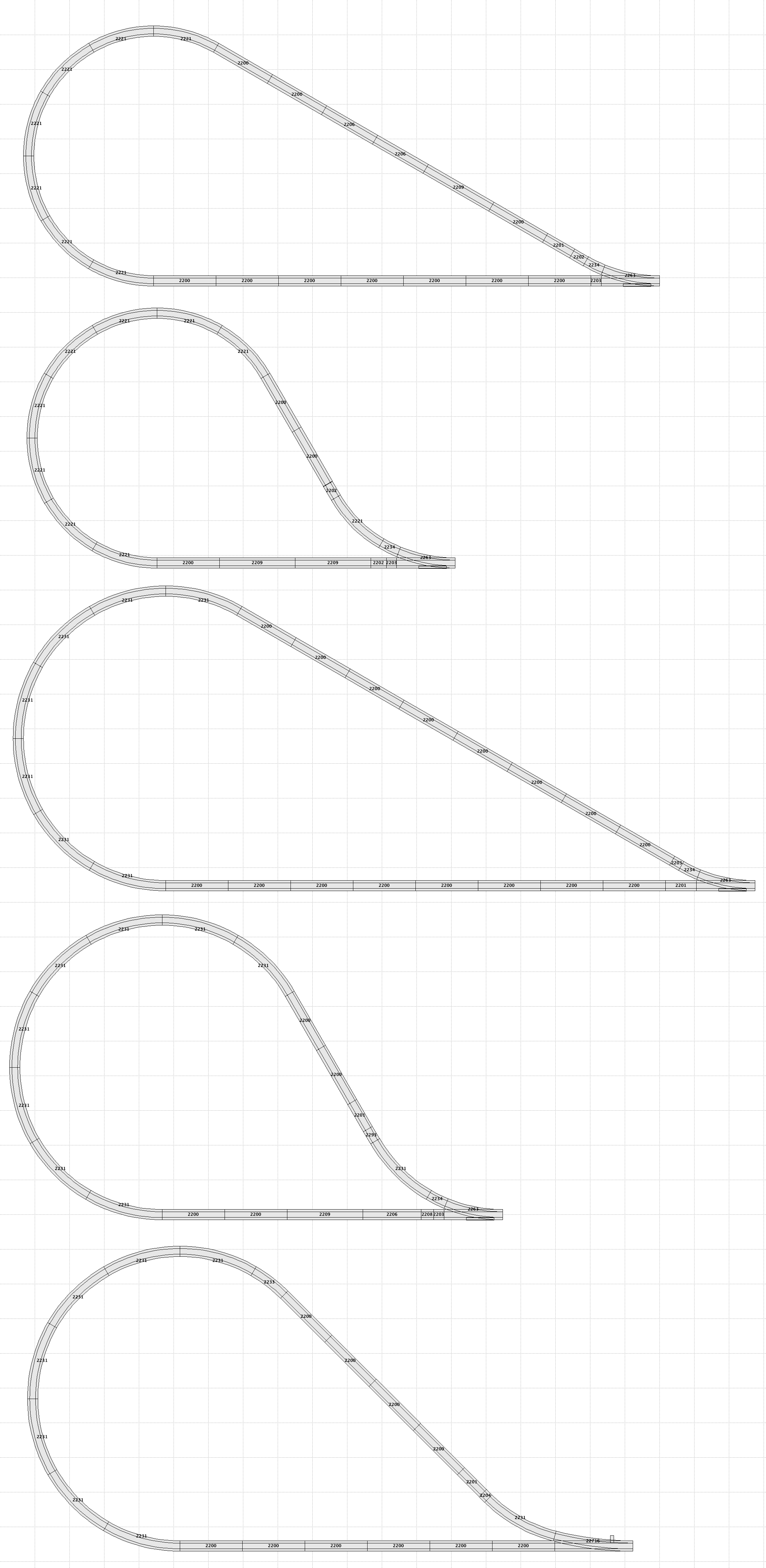

Some C-Track reversing loops, you may have to download them to make out the part numbers.
Must build something
thanks 1 user liked this useful post by scraigen

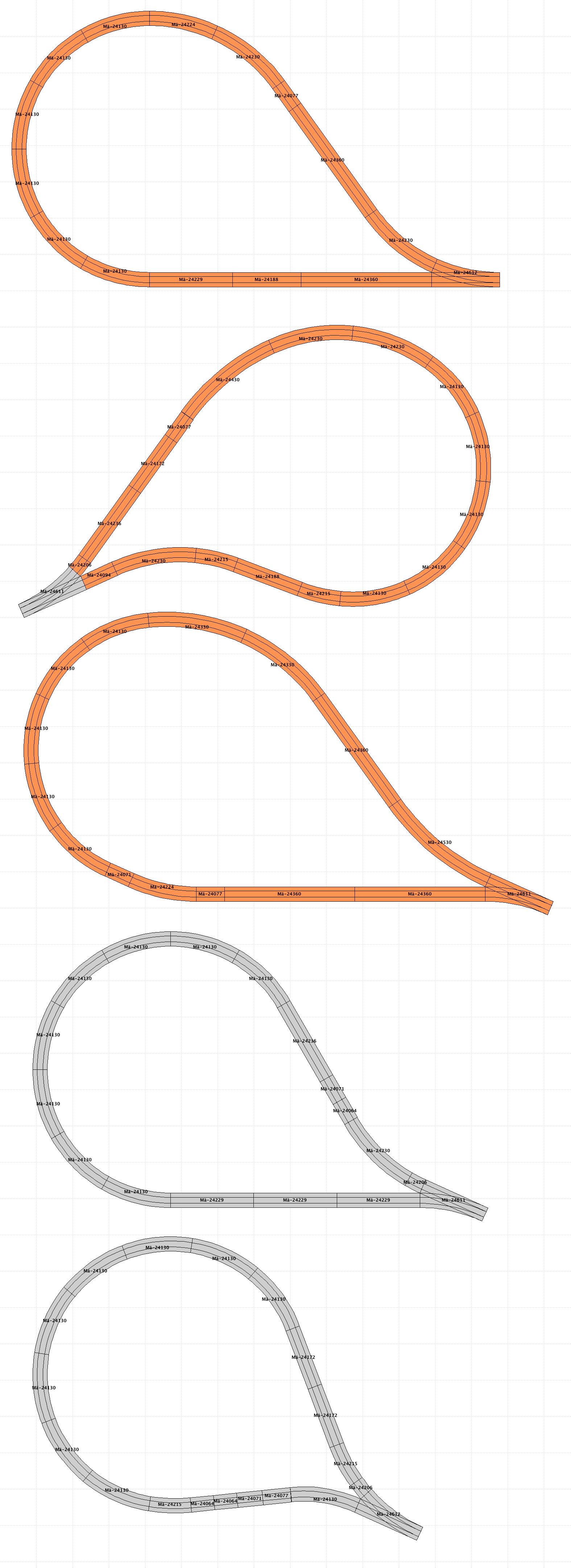

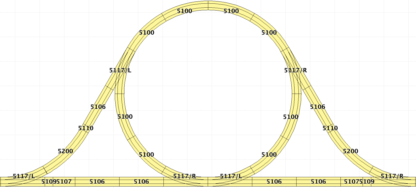

An M-track double overlapping reverse loop, obviously simple to modify for either a single left or right loop.
The four points on the circle can all be sprung and never need changing, just use the points at the two extremes to direct traffic into the reverse loop.
I built this and it works really really well.
thanks 3 users liked this useful post by scraigen

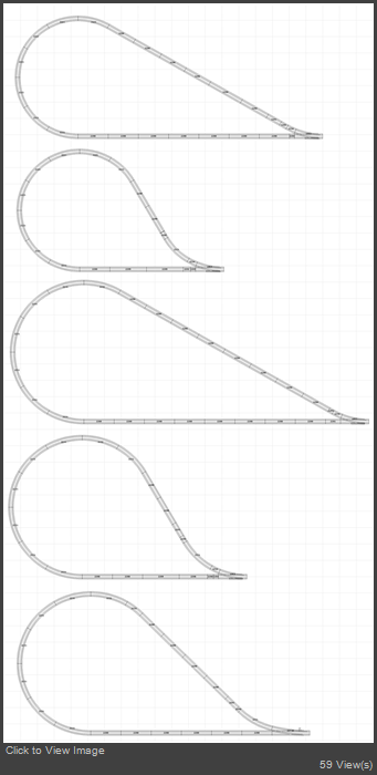

And finally some K-Track reversing loops.
thanks 2 users liked this useful post by scraigen

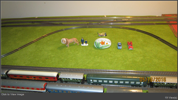

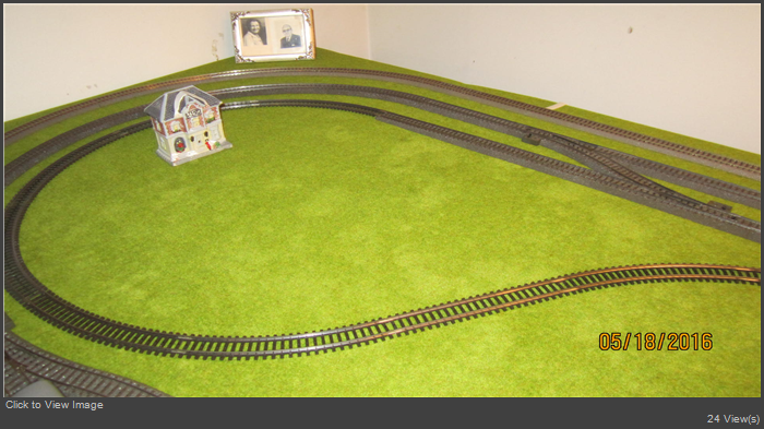

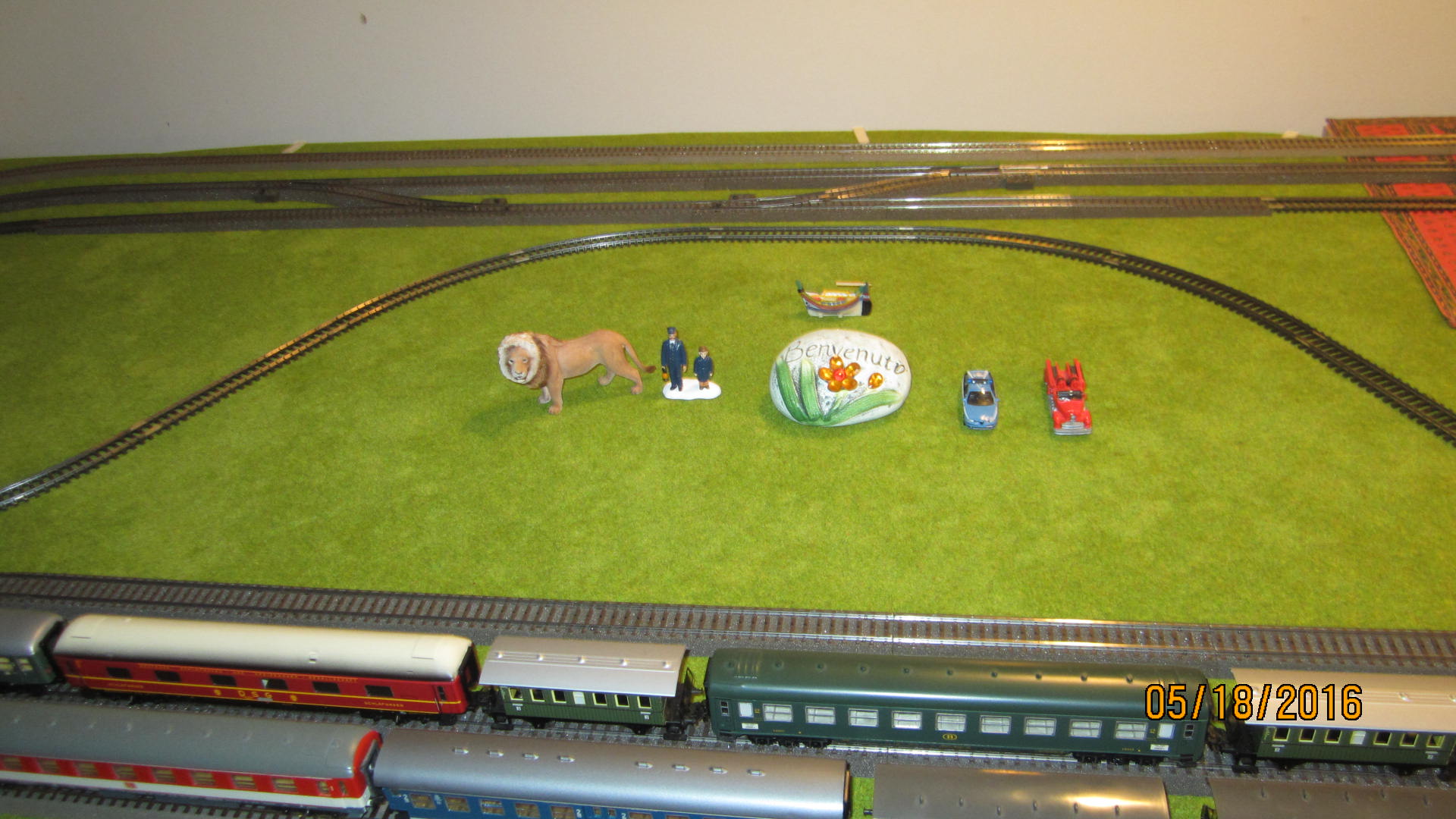

Well, I digested all the great suggestions I received and came up with solution of my own.
Following the model of a reverse loop, I adapted that plan to make two separate loops of sorts that do not reverse but still suit my purposes.
I have now added one extra oval that has a herring bone, much like the one that Mike C. showed me at the exhibition last year at the Dutch senior citizens home. Thank you, Mike. ThumpUp
Since I needed a size that was less than an R1 radius, owing to space limitations on the layout, and was concerned that the M tracks would be too small, I used the K tracks I recently dismantled. The result has been really good. BigGrin
On the new herring bone K track layout I can run almost anything I like, including my famous FS 424 loco pulling the three new illuminated coaches I got for Christmas from my wife (cat no. 43570). Interestingly enough, on the K tracks, the noise of the slider almost completely vanishes and it is a real pleasure to see the train go so smoothly on these K tracks. Laugh
I have a pet project of creating an imaginary train from Toronto to Rome and each loop is intended for each one of the two cities.
In the pictures below, the first picture shows the centre of the layout; in the second picture you can see the Colosseum surrounded by my FS 424 and the three 43570 coaches mentioned above; the last picture shows on the opposite end the Toronto station - I will get asap a CN Tower to put there. (The photo shows my parents, now gone. My father is the one who got me into this hobby about 50 years ago.)
Overall, thanks to all your initial suggestions, my layout has greatly improved. Life is good. BigGrin ThumpUp ThumpUp
