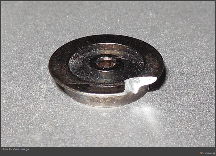

Well, I took a spare wheel and cut into it with my Dremel tool:
I had assumed the newer ones were brass, but apparently not. It is some type of metal alloy silver in color. Why do I say "alloy"? It is too heavy to be nothing but aluminum. It could be mostly zinc, but doesn't seem as brittle. The metal is fairly soft, cutting the wedge out of it with the Dremel tool only took a couple seconds. Oddly enough, the wheel will just barely stick to a very, VERY strong magnet, but just barely. The metal is way too soft to be nickel. Obviously, it will take color from a metal blackening solution. I hope this gives someone better versed in metallurgy than I enough clues to figure it out.
thanks 2 users liked this useful post by DTaylor91
