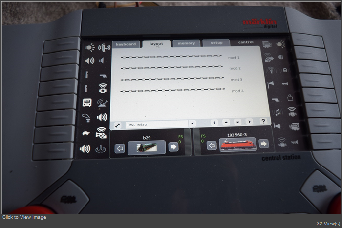

Hi everybody Cool
I follw the advice of Fabrice and I configured a layout of test S88 on my cs2.
This week I shall test every connection one by one
I hope that it's correct
To see you later..
Thewolf
Offline French_Fabrice
#6 Posted : 26 April 2016 07:53:31(UTC)
French_Fabrice
Joined: 16/05/2011(UTC)
Posts: 1,489
Location: Lyon, France
Yes, It seems to be OK;
fabrice
