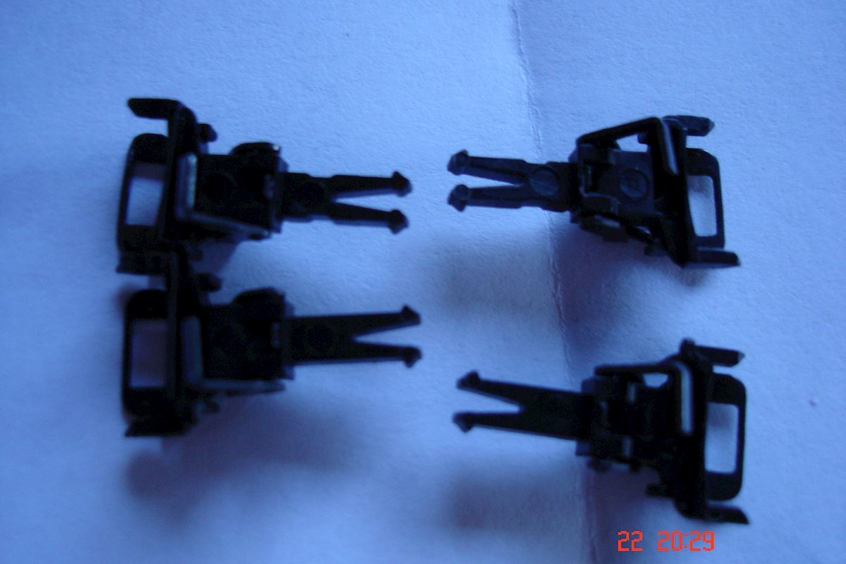

#29 Posted : 22 December 2016 07:30:30(UTC)
dominator
Joined: 20/01/2015(UTC)
Posts: 1,204
Location: Kerikeri
with the recent purchase of Trix and Roco wagons, i found 2 of the wagons had the older loop couplings in the close coupler socket. Thought that was a waste so i fitted 4 close couplers. One of the wagons kept loosing its couplers and on close inspection I found I could not push them right home. I removed them and checked them withe ones that came out and found they were different. I sorted through the couplers I had spare and found there really were two different designs.
thanks 2 users liked this useful post by dominator
#30 Posted : 23 December 2016 08:31:43(UTC)
Posts: 6,776
with the recent purchase of Trix and Roco wagons, i found 2 of the wagons had the older loop couplings in the close coupler socket. Thought that was a waste so i fitted 4 close couplers. One of the wagons kept loosing its couplers and on close inspection I found I could not push them right home. I removed them and checked them withe ones that came out and found they were different. I sorted through the couplers I had spare and found there really were two different designs...........
Do you mean the design of the spigot part that goes into the pocket, not the loop and guide part?
#31 Posted : 23 December 2016 08:45:55(UTC)
Posts: 15,488
I guess that what he refers to.
This groove can make it difficult to insert the coupler the full way. Still you have to get it in completely to achieve full pulling power.
Offline Jabez
#32 Posted : 24 December 2016 00:38:32(UTC)
Jabez
Joined: 30/08/2016(UTC)
Posts: 636
Location: Brussels
For a thread dealing with couplers, I am surprised that no one has yet directly referenced this article. http://blog.mailez.de/eb...-couplers-for-h0-models/
Offline dominator
#33 Posted : 24 December 2016 06:41:30(UTC)
dominator
Posts: 1,204
Location: Kerikeri
HI Jabez. I've been through all that and proved the Roco universal is the best coupler by far. I thought I would point out the 2 differences I found.
Kimball. yes, its the spigot part that goes into the socket. Surprised me.
I will purchase more of the Roco universals later. I have used up the 50 I bought some time ago.
Dereck
#34 Posted : 24 December 2016 13:24:20(UTC)
Posts: 15,873
I've noticed before that some of the Marklin close couplers have a different design of shaft, but they should all still fit in the pockets.
I'm a fan of these couplers and fit them on all my stock as far as I can. My Roco, Liliput and Piko wagons have no trouble working with the Marklin close couplers.
#35 Posted : 24 December 2016 14:07:04(UTC)
Posts: 15,488
I did have problems with Roco freight cars when Märklin close couplers were involved.
Longer cars are more likely to cause problems.
