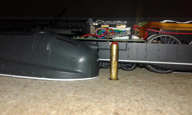

I was thinking of getting a Marklin 39618 (BR 61 in Dark Grey) and adding smoke to it. Looking for the feasibility of doing such a conversion for members that may have the loco. here's an inside shot showing the decoder located below the area where the hole would need to be drilled. Do you think there's enough space for a seuthe #10?
Thanks!
Chuck

Chuck looking at the loco there is enough room but is the room usable ? with a 39... loco type you can't just un-solder the wires and move them somewhere else. and messing around with the fixed wire band I wouldn't risk it. whether or not you can dd a shorter smokeunit only you would know, go to Seuthe.de and have a look at the smaller smoke units and see how long they are, than it is a matter of measuring if a smoke unit can be fitted, the other concern is always the heat the smoke generator creates so you wouldn't want it to sit on top of the decoder.
I've asked my self for years why Märklin hasn't put smoke generators in some of their locos., I'm just converting an older locos BR 38 and fitted a smoke generator and I have done this on many others even with a plastic housing, another loco springs to mind BR 96, BR 78,
Unless you move the whole lot from the front I'd say you've got slim chances. has this got sound ?

Yes John it has sound. If you look at the pic in my initial post, the black box with the two white wires is the speaker. My first thought was to install a smoke unit with the wires extending out the bottom that is the equivalent to the Seuthe #10 and using a miniature connector so it could be separated from the body shell for maintenance purposes. You can see the red (hot) and brown (ground) wire where it could be connected for power. A piece of insulation could be placed between the decoder and the base of the smoke unit if clearance allowed.
The more I think about it, it may just be too much of a headache to be worth it in the end. Unsure
I just think it's irksome for Marklin to design steam engines without the capacity to easily add a smoke feature. The BR38 and BR96 are other good examples of engines not readily available for smoke unit installs.

Hi Chuck
After having a good look at my loco and lifting it's lid, your assessment "too much of a headache to be worth it" is spot on.
There really is very limited space available under the smoke stack. The internal shell height, at the smoke stack, is 25.5mm, the smoker length (marklin 7226, which I think is very similar to the Sleuthe #10) 23mm and then the decoder etc. stick up off the frame by about 16mm. So there really is very little space for you to play with in there.
I have got a photo and will try post it shortly.

Thanks Angus, that's just the info I needed. ThumpUp
I agree that there's just not near enough room under the stack area to be able to add a smoke unit without considerable "surgery". Sad
