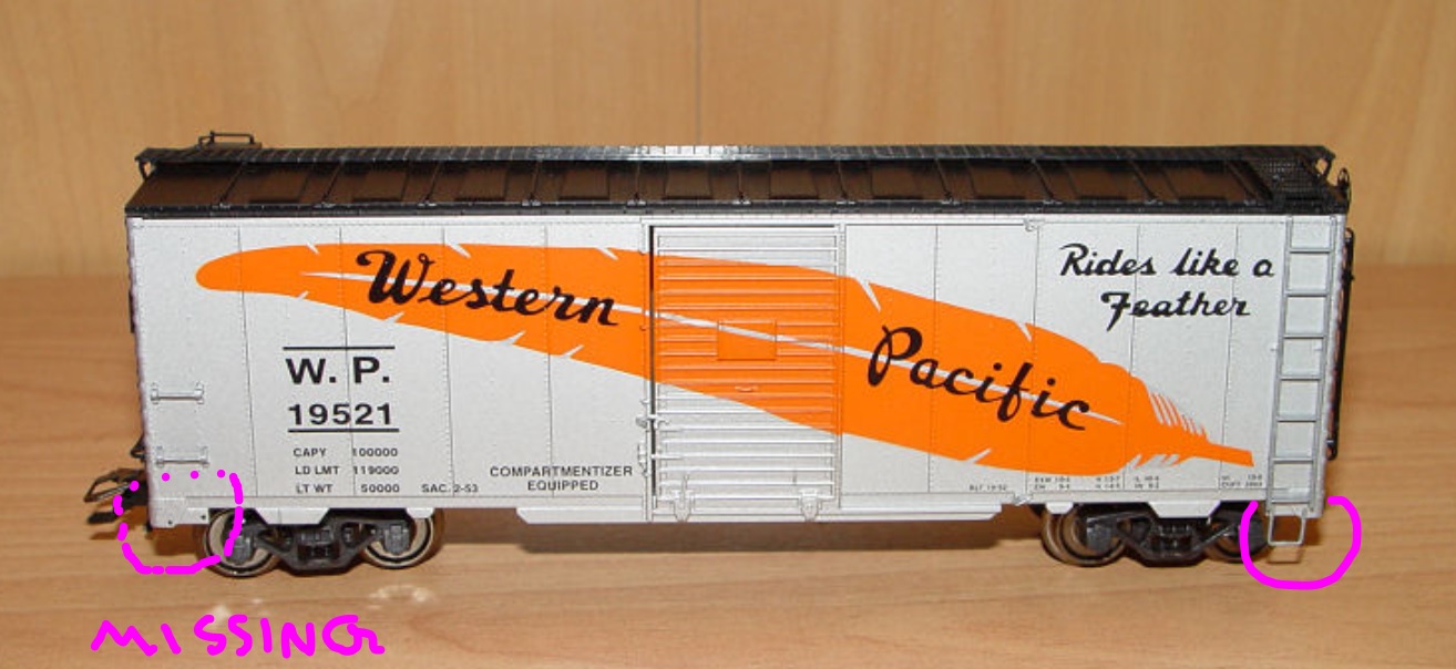

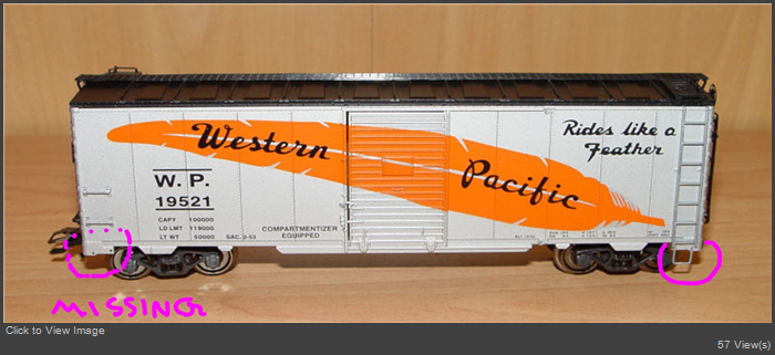

I've searched the forum as best I can, and the interwebs, looking to obtain something close to "OEM" replacement parts for the side-mounted stirrup step.
It seems we scrape them off by the dozen. Every little mishap results in lost stirrup steps from our "plastic" US-prototype cars.
We are not alone. You'll notice that many of the cars for sale on Ebay or elsewhere are missing these steps, too.
Anybody know where to find a close approximate?

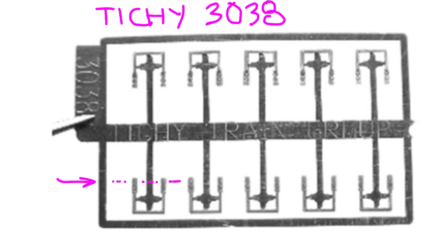

Tichy 3038 is somewhat close, but as the name states, the step is "straight" across the top. The M-version is not.

Nice question.I do not think you can find them as a spare part.I am always careful with my USA cars because of this.Double checking before i put them on the layout,maybe they are dropped in the box,and checking again the time they are leaving the layout.If i noticed any of them missing,i am finding it at once and with a very little guantity of glue is on the right position again.I have some from spare from broken cars too.

Yes, it is a problem with all the plastic USA Boxcars and wagons. These small steps are also just a push fit and not glued in place at the factory. I have to check very carefully before and after use. I considered using glue, but it is easy to use too much glue which may show on the wagon body, so I just decided to live with it.
It may be possible to make resin moulds and cast some new steps, though they are a bit fine for resin.
I agree that it is very unlikely that spares will be available from Marklin, the steps have been made in many different colours as well.
The spares that you show in the picture are a very close match though and could be painted to match. Where did you buy them from please?

ANYHOW, I used to spend many, many hours drilling car bodies and locomotive bodies to add detail parts. It looks like it would be a simple matter to use the Tichy steps after drilling another hole in the Märklin body level with the upper hole. Not sure what size drill it would require, probably something between #70 and #80. Get a pin vise and drill it by hand. Tedious, but drills that tiny usually cannot handle the stress of a motorized drill.
Also, look into these two companies for other detail part possibilities: Detail Associates, and Details West.

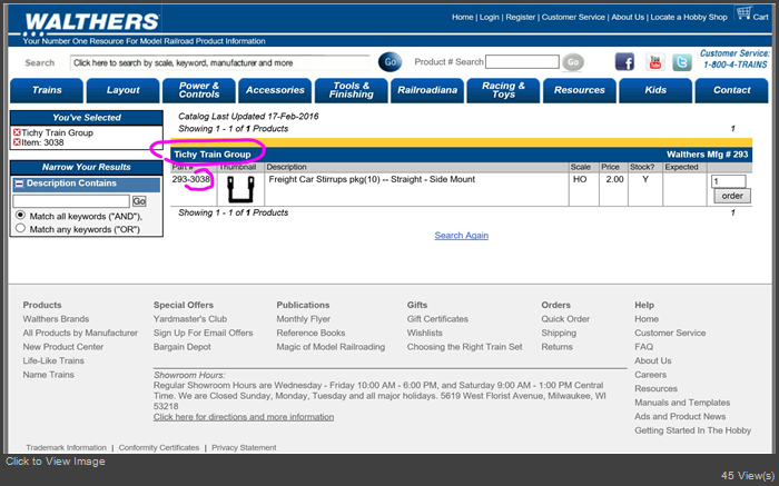

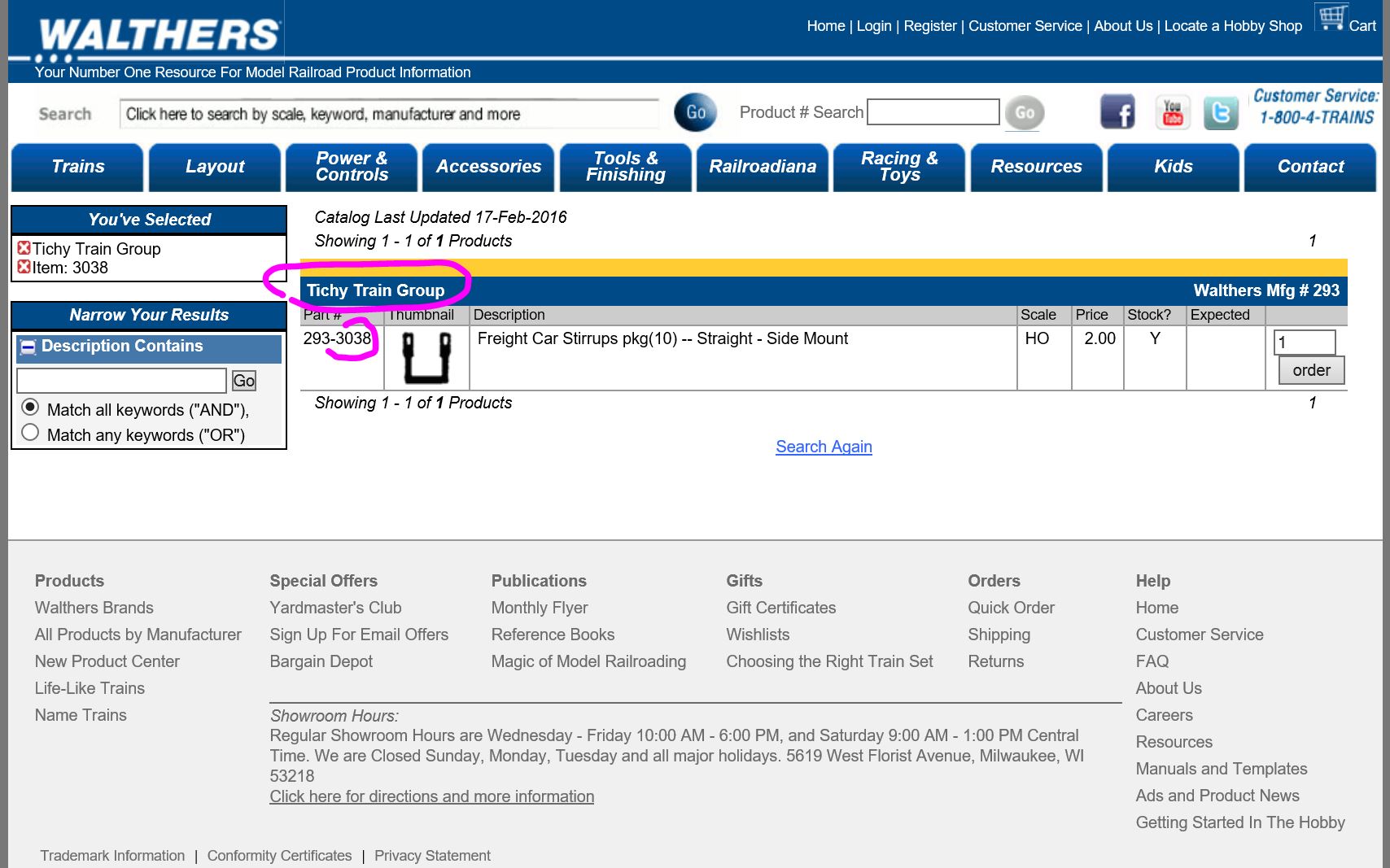

Regarding Tichy steps and "Where can these be purchased?"
My experience is limited to the US:
I have seen them in larger train shops and for sale, on-line, at most model RR suppliers.
Boxcab

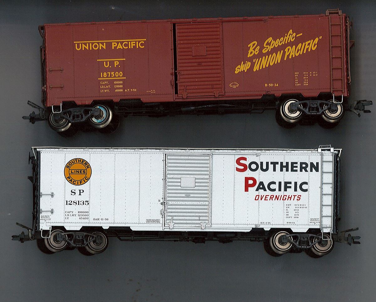

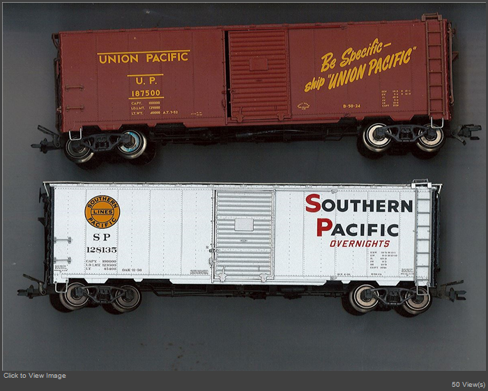

Thanks to RayF's (sorry Ray--I had the wrong name) suggestion to make my own steps, I have found a solution which will work great for my needs.
It worked far better than I expected! Thank you!
I've added a couple steps to the red-car; one to the silver car for comparison to the factory step (factory is at right)
None of these steps has been painted or even glued-in, yet, so you can see what they look like.
I'm sure other people can make still better replacements than my handiwork, using more patience and better tools.
For myself, considering the alternative of shedding the steps every time one of these cars bumps into a small mishap, I like this alternative.
This is because these home-boy replacements are far more robust than the factory pressed-in steps--the staples pass well under the car, and will give a good glue contact.
And you can get the material for 5000 of these for about a dollar, and make them any time you need them!
Boxcab.
