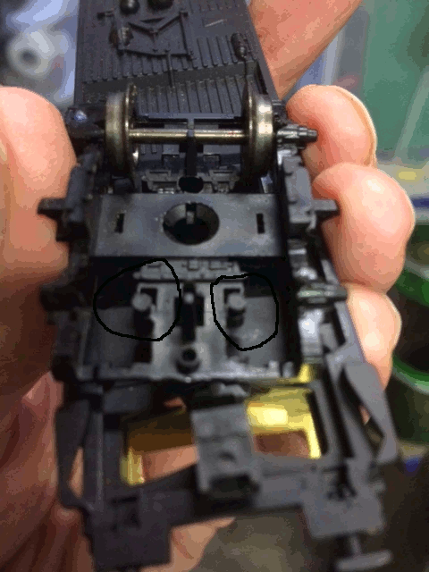

Offline morsing
#12 Posted : 13 October 2018 10:30:28(UTC)
morsing
Joined: 16/08/2014(UTC)
Posts: 619
Location: Aylesbury, Buckinghamshire
I can't see anyway for wheels to be fitted wrongly.
However, I think these two buggers are the culprits. They sit so close to the axle the metal doesn't fit. Do I cut them off?

#13 Posted : 13 October 2018 13:12:32(UTC)
Posts: 14,881
strange, unless something went wrong when they put the undercarriage into the mold and weren't removed, how come the carriage doesn't move now did it move without infringements before ? what does the other bogie look like, is it the same ?
From the image posted you can see that it is clear under the other bogie. I am guessing that those are casting sprues which did not get removed during machining. If you want to mount an axle there I would say that you have to remove them.
If you do that carefully no one but you and Märklin (and all of us) ever has to know. BigGrin

Offline twmarklinfan
#16 Posted : 14 October 2018 12:10:48(UTC)
twmarklinfan
Joined: 08/05/2015(UTC)
Posts: 579
The two buggers are there to hold the axles in place. I have had exactly the same issue, pushing the axles back into place the buggers do not separate enough and form a brake on the axle. The solution is to take a small screw driver and prise the top of the buggers away from the axle. The axle should drop a fraction and the buggers will close over the axle and the axle should spin freely again. It may take a bit of jiggling but it should work.
Offline morsing
#17 Posted : 14 October 2018 21:58:22(UTC)
morsing
Posts: 619
Problem solved!
I can tell you that all my four coaches, on both bogies, have those pins. Don't understand why...
I cut them off and it rolls a charm now :-)
