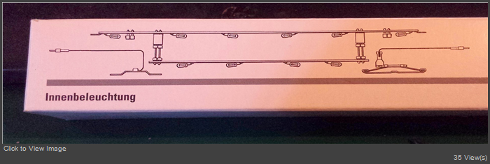

Ok Bill,
Its the 73140 lighting set.
Includes the double bank of lights (globes NOT leds)
2 x current conducting couplers
1 x offset pickup shoe
2 x "A" frame thingy's for the coupler power
1 x current pickup for the wheels
and the extension whatsie to bring the power feed up from the wheel pickup
Tom,
These particular bits came from Nev W's clear out end of last year.
Shamu attached the following image(s):
That could be a problem: the trucks do not have an offset pivot point and the offset slider may lead to problems (if it fits at all).
The set 73140 is for the 264 mm double stock coaches, the question is about the 303 mm double stock coaches. Did anyone install lights into the 303 mm coaches?
