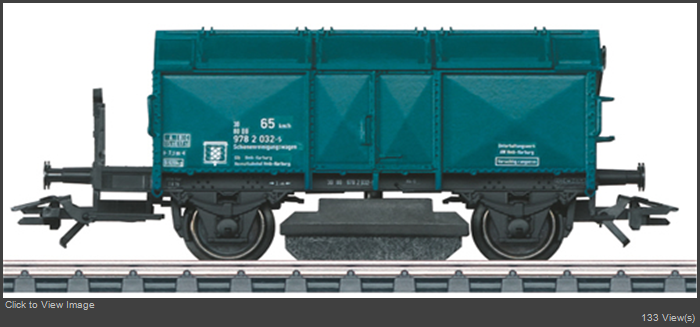

I bought yesterday a track-cleaning wagon from Marklin.
The question is whether I have thrown out my money (CAD$57.00) or not.
In other words, what can I realistically expect this wagon to do? Is it any substitute for the "elbow grease" way of cleaning dirty tracks?
The wagon itself is very nice (see picture), but does it do the job? The pads are now dirty after about 20 runs on the long track and expect to clean them with rubbing alcohol (Isopropyl).
Thanks.

#2 Posted : 28 March 2015 18:17:10(UTC)
Posts: 9,375
Boy...
You do really have heavy dirt on the tracks!
This cleaner wagon do only work to clean dirt as possible.
If you want to clean harder on the rail,i suggest chemical gasoline and the tops or old cotton shirt.

I don't suppose there is ever any real substitute for "elbow grease". Having said that I do have very good results with my cleaning car. I usually empty the tracks of rolling stock/locos, as far as possible, and hook up the wagon to one of my start set locos. A few "fast" laps around the circuit will get rid of most of the grime. For the shunting bays, the loco needs the tortoise switched on, and a number of "to and fro" runs clear these tracks as well. Make sure you change pads when they get too dirty!
Cleaning: I use warm water, with some dish- washing liquid, and a hard bristle tooth brush, or nail brush. They dry pretty quickly.
Its not always easy getting to those hard to reach track pieces, with scenery/catenary/signals and such like getting in the way, so I really do find these wagons work well enough.
To clean the studs (during those wintry days that aid the settling in of rust), a few fast runs with a start set loco, and the slider does the job nicely!
Joe
thanks 3 users liked this useful post by Joseph Meiring

As far as track cleaner goes , it is no substitute for elbow grease on heavily soiled rails, but I think it works good for normal maintenance. Like Joe we clear the lines on the layout and run it around with one our workhorse locos. We like to put diluted ISO on the pads to help with the cleaning, then clean them with the same when finished.
Gordon

Miniature Wunderland in Hamburg, have a track cleaning car in almost all, their freight consists, and some of their Pax ones as well (bagage van behind the Damph Lok) They told me they "had too" to ensure trouble free running of the layout (both the three rail and two rail sections) and they have trains running all day every day !
The normal wear of the slider takes care of the studs but they replace a lot of sliders ! Wink
I noticed lots of the Marklin ones but they use Roco ones and others too. I believe I saw a "maintenance consist" with the Lux vacuum cleaner car as well !
I have an M46042 and soak the pads with methylated spirits (alcohol with an additive to make it unpalatable RollEyes ) and use it on my test/play layout (as well as the club modules before running my trains Sneaky ) every now and then especially after newly oiling a lok and running it Scared
I have an egg cup for the soaking but also a fine needle "oiling bottle" with the meths in for applying it to the pads. After a "dirty session", I rub the pads on paper towel after a soaking with meths to clean them, so I haven't, as yet, used any of the spare pads that came with the wagon ThumpUp
Glen

Thanks everyone for your thoughts and assistance. Much appreciated.
I think the moral of the story is:
1. If the tracks are REALLY dirty, you need elbow grease;
2. The cleaning wagons are fine for PREVENTIVE maintenance, so that the tracks do NOT get too dirty in the first place;
3. Best to soak the wagon pads with Iso.
I think I have noticed an improvement in performance by using this wagon many, many times in 24 hours and having soaked the pads in Iso. The lights no longer flicker. BigGrin
Overall. I am glad I bought it, but I have to be realistic as to what it can and cannot do, as discussed above.
