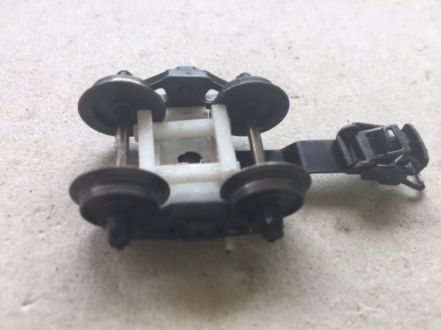

Got myself a second shell for kit bashing.
Edited by user 03 September 2015 21:10:43(UTC)  | Reason: pic uploading problem
#8 Posted : 03 September 2015 23:07:30(UTC)
Posts: 6,051

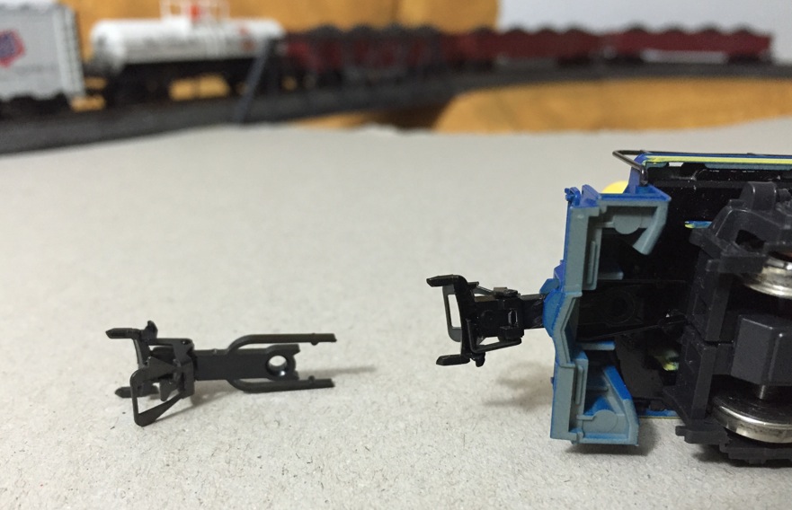

What can a man do with this (decoder/pick-up shoe, M* coupler)?
For a start, install one of the couplers.
Yes, I know, but I have mainly US tinplate freight cars with M* couplers at the bogies.
Reminds me that I still have to mount the missing front and rear railings.

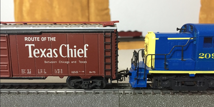

#9 Posted : 03 September 2015 23:15:41(UTC)
Posts: 8,624
Pity you couldn't shorten the shank a bit, just looks to be sticking out too far - but then you may need that on tight curves anyway.
Be interesting to see a 'helicopter shot' coupled to a wagon on an R1 curve.
#10 Posted : 03 September 2015 23:23:22(UTC)
Posts: 6,051
As requested: helicopter view on R1.
Not the smoothest ride. Need to adjust, but I am only in the initial test phase.
;o)

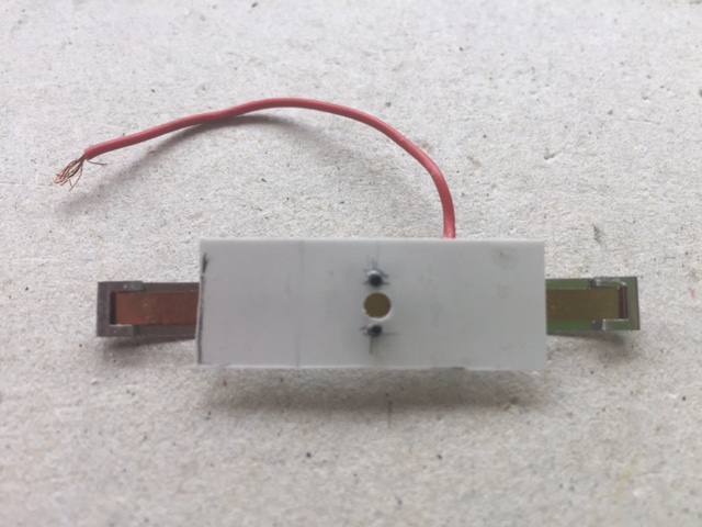

Tight space: The decoder sits now under the cab in the space between cab roof and glass insert.
(Re-)cabling: All black cables go on one side now, connected to the black decoder exit cable. Orange and grey decoder exit cables soldered to either side of motor feeder plates (which - formerly connected to the "original" black cables - are now isolated), respectively. The single lightbulb remains in the middle, connected to both yellow and white decoder exit cables. Engine and light functions were tested in a "dry run" on a programming track.
Finally, the red cable goes to the "third rail" pick-up shoe. The latter is fixed with hot glue under one of the trucks. The pick-up shoe will be subject of the next post.
#12 Posted : 05 September 2015 20:17:47(UTC)
Posts: 8,624
;o)
Thanks, looks like it would be fine with a shorter coupling shank, hard to tell with the lighting - don't worry, I'm not moaning.
I think you get away with it as the loco is reasonably short, about the same length as the gondola.

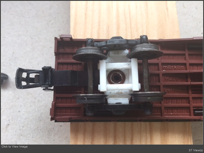

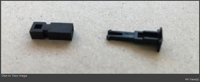

Found anyway a better coupler solution:
Short SYMOBA holder on the inside and a short M* coupler hook on the outside.
stays conveniently in place without screw or glue.
And looks "unsuspicious".
:o)

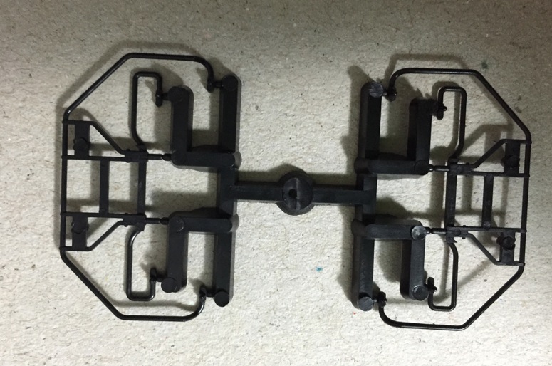

And now the announced "third rail" pick-up shoe installation report.
I had to shave off a lot of plastic under one truck - until the cog wheels were visible - to create enough space to allow the loco to glide over turnouts, with the curved turnout being the most challenging one. Actually, I had to shave off more material after taking the photo.
Here is the final view after fixing the pick-up shoe with hot glue. There is enough space in the middle of the truck to safely lead the feeder cable up to the decoder inside the housing.
#16 Posted : 05 September 2015 22:33:01(UTC)
Posts: 6,051
That does look a lot nicer and less intrusive on the end not coupled.
What is the Marklin part number for that coupling - oh, and the symoba pocket?
#18 Posted : 06 September 2015 00:21:16(UTC)
Posts: 6,051
Märklin 399740 "Kupplungshaken"
SYMOBA "Schacht kurz 110"

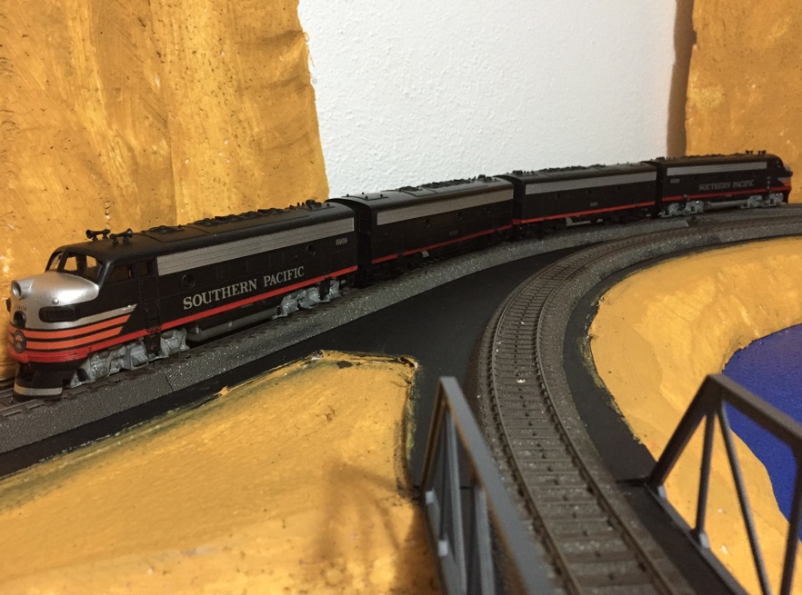

Success, the SP F7 Black Widow ABBA set is up and running.

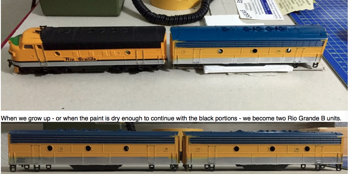

#33 Posted : 22 October 2015 22:48:49(UTC)
Posts: 6,051
The can rattling continued.
Next step is the black stripe between the silver and yellow parts.

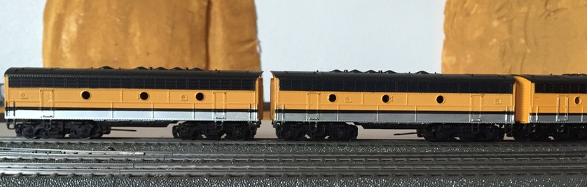

Now, that went better than expected: The Rio Grande F7B units with spray painted black stripes.
(Grab irons and fuel tanks still to be attached.)

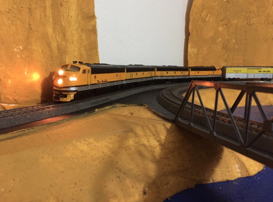

D&RGW F7 ABBA fast freight loco up and running.

Those D&RGW B units (and caboose) came out perfectly. What did you use to mask the lines while painting? I have seen some small masking tape for modeling. Your lines look so clean, I was wondering if you had used something like that?
-Brandon
#40 Posted : 11 November 2015 18:35:31(UTC)
Posts: 6,051
I used the best product, I could get here: tesa® 4333 PV1 Precision Mask® Sensitive
http://www.tesa.com/indu...on_mask_sensitive,i.html
Plain areas were unproblematic, but around the fixed grab irons at the corners and doorsteps required extra attention.
There isn't anything, tape can't fix:

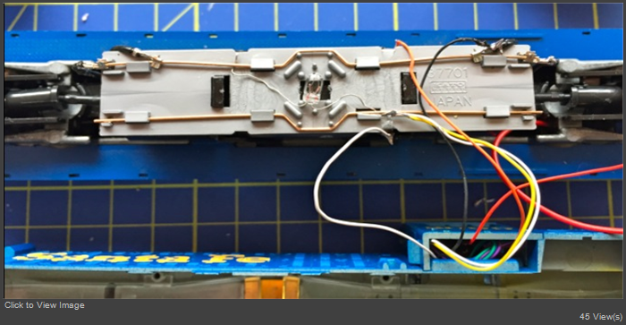

My first analogue to digital conversion of two F7As successfully completed. Process documented:

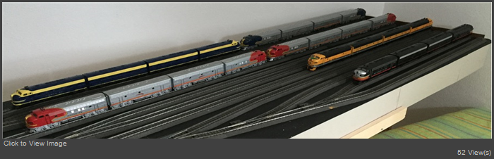

Quick headcount after the above operation:
6 x EMD F7 A-B-B-A in the stable.
Each with two motorized and two dummy units, respectively.
:o)

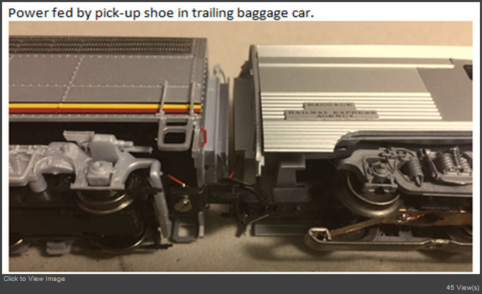

AK, I know its a bit late to respond to your conversion but my suggestion may help you in future. instead of filing and shaving off the plastic part I have added a electrical coupling and than used a carboose or anything similar to add the slider (elelectrical as well) but this means the loco is no longer travelling on its own and this is of course for 2 rail locos which can't be converted to 3 rail

... I have added a electrical coupling and than used a carboose or anything similar to add the slider (elelectrical as well) but this means the loco is no longer travelling on its own ...
Thanks John,
I might even follow this advice, as rolling over turnouts/switches/points (especially curved ones) is a challenge, because the pick-up shoe is lifting the loco a little bit. And as a busy shunter-gatherer, the loco should never move without a car.
:o)

Life Like Proto 2000 Santa Fe EMD E8/9 successfully converted.
Also not depicted: The distance between the wheel flanges on the front axle and the trailing axle have been reduced by pushing them gently together. I did this with two finger without dismantling anything. Before this intervention, the loco tended to derail when following the inner path of the R1 curved turnouts when "splitting the frogs". Now she is hovering over all C-track sections like a goddess.
Edited by user 13 October 2016 22:31:25(UTC)  | Reason: Not specified

#50 Posted : 25 October 2016 13:59:11(UTC)
Posts: 6,051
There is something in the works. We are building an external power feeding device for converted former H0 scale 2-rail freight locos which do not offer enough space for installing a “center rail” pick-up shoe (converted passenger loco to be fed by coach equipped with Maerklin 73405 power feeder instead).
Ingredients: thinnest “Evergreen” white styrene sheet, 2 mm styrene rods, “Ibertren” article #9001 pick-up shoe for “three-rail” conversion, plastic glue, cable and soldering tools, screwdriver, sharp hobby knife, drill, Maerklin H0 gauge US flat car.
The works - (1) Build a well.
(2) Make shoe plate separately for easy adjustment when placing it in the center (see image #4 below). Hole is for later maintenance access to the screw holding the truck (shoe can be lifted after removing the two tiny screws).
(3) Truck and ring washer in place. White base plate fits nicely around raised round "thread housing". Subsequently the truck is attached with the existing screw (not pictured).
(4) Feeder cable exits through opening in the well. Shoe plate glued down after final adjustment of central position.
Ready to roll.
I experimented with other US tin plate freight cars. Best combination offers one with screw-mounted trucks and a long coupler neck to avoid contact between coupler and pick-up shoe, i.e. a flat car is the only candidate. Cabooses have also long coupler necks, but the truck held by a retaining ring do not offer enough space for even the thinnest styrene sheet. Gondolas have screw-mounted trucks, but short coupler necks. Box and tank cars have retaining ring-fixed trucks and short coupler necks.
Edited by user 25 October 2016 18:23:03(UTC)  | Reason: Not specified
