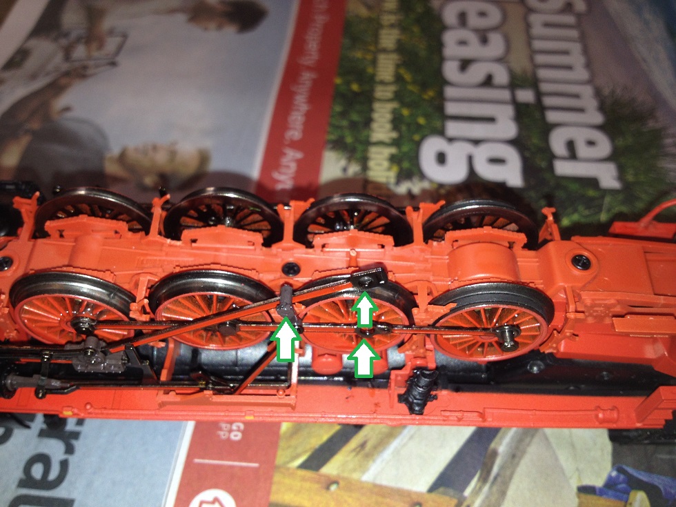

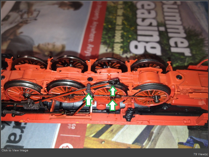

I bought my first steam engine, a BR41 MFX+ 37923 about a month ago. My layout consists of diesel freight trains and a couple of electric commuter railcars and an ICE. Therefore I was very excited about adding a steam locomotive for 'tourist runs' around my layout. My excitement turned to misery yesterday when the 'Gestänge links' broke off from the wheel as the locomotive was running around my layout. It appears that the screw attaching the 'link' to the wheel has broken off leaving part of it in the wheel.
I have looked at the parts list and obviously these parts can be replaced but it looks like a fairly complicated task and the screws look like they need a special tool to tightened them into the wheel. Whilst I know it is covered under warranty, sending it back to Germany is quite costly. I have contacted the store I bought it from, MSL to see what they can do to help. In the past they have been very helpful when items I bought from them have failed as far as arranging returns. I await their response when they open today.
Has anyone here had a similar failure on a new Locomotive? I have attached some photos to show the problem.

Hi, Paul,
I'm sorry to see you're having a problem.
The fault is with "Gestänge rechts" (right side), not "links" (left).
I can't see enough details on your picture, but I think the new locos have a plastic part that is just clipped in. I can't tell from your picture whether it just came off or got broken. Still looks like a long peg.
The peg won't be round and it can be pushed in in just a certain position.

Thanks for the quick reply Tom, it definitely is broken. If it is just a peg that pushes in, that should make the repair a lot easier, they just might send me the new peg and I can do it myself. The parts list has them as 'Sechskantanschraube' whatever that means. I think if they are in fact plastic, that is a bit flimsy from my recent experience with the short service life.

Hi Paul, if it is plastic yes I can believe it will break if there is the slightest misalignment or tight spot. Bring on the old one's with real screws when Marklin was really Marklin. Try to repair yourself if you can. Sending back will be an expensive exercise but note the part you are after is #25 Gestänge rechts E233 574 @ EUR29.50 & is expensive & this may be the reason you want to send it back under warranty. Pin is not sold separately by the looks of the diagram.

#6 Posted : 20 October 2014 11:58:35(UTC)
Posts: 15,873
This sort of thing never happened with "old Marklin" because all the running gear was grossly overscale and built for strength, not accuracy.
Unfortunately some of the new locos have parts which are prone to breaking. Marklin need to keep an eye on the materials being used on the most stressed parts of the running gear to avoid breakages like this.
There is #5 "Schraube", #6 "Sechskantansatzschraube", and #7 "Sechskant-Ansatzschraube".
These are metal screws with hexagonal heads. Close inspection of loco and diagram will reveal that those screws are used for the other three axles.
It's good to have such a screw at axle #4 so you can replace the traction tyre.
It's completely different for the third axle where the rod from the cylinder ends - the rod that came off with your loco. You can check the left side of your loco: there shouldn't be a hexagonal metal screw at this axle.

Hi Paul, all,
I bought another new style Märklin steam locomotive as a project many months ago (37915 Insider DB BR 03.10). It had this kind of problem and I ordered new parts. I´m not sure if this BR 41 has the same type of parts, but 37915 had a metal part which was just pushed in. When I removed the broken part I had to use small pliers to press it together from the back side to be able to pull it out of the wheel. New part was just pushed in and kind of locked in place, because it can expand a little when it has got through the hole in the wheel etc.
Edit: Are you sure you have any broken parts as to me it looks like the part has just popped out and needs to be pressed in. Just snap it back in and don´t forget to put that siderod back between the part and the wheel. I may be wrong, but for me it just looks like it has got loose.
I´m sorry I can´t really explain this better as I´m not a native English speaking person.
Is your part plastic or metal? In that 37915 it is metal. Märklin has chosen those new style parts as they look more realistic than basic bolts and nuts. This is the price we pay when we want our models to be more realistic looking.

I just took three photos of my newer generation steam locomotives. Photo quality is not very good as I took them with iPad. Anyway you can see from them that all have this same type of metal part going into wheel without any bolts or nuts.
DB BR 41 (37927):
DB BR 03.10 (37915):
DB BR 39 (39390):
Janne
thanks 5 users liked this useful post by Janne75
#17 Posted : 20 October 2014 20:49:15(UTC)
Posts: 31,722
Post 2012 new 39016/39017 BR01 coupling rod without metal 'nut' on center deiving wheels (see first picture).
The 2006-2011 models BR01 Ref number 39010-39015 came with metal 'nut' (see 2nd picture).
39016/17 service sheet have error as shown 'Nut' on list. I hope Marklin is point out error on service sheet.
thanks 7 users liked this useful post by steventrain

just an update, the piece is definitely plastic and the pin that goes into the wheel has broken off. The locomotive is now on the way back to Germany for repair. I guess I'll just have to wait for it to come back. Disappointing!
