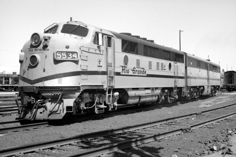

Prototype History:
When D&RGW first started California Zephyr service, they originally purchased two Alco PA-1 A-B-A sets to run as motive power due to a dispute with EMD regarding power ratings (CB&Q and WP purchased F units from the start). Soon after, the dispute was resolved, as Rio Grande Purchased three A-B-B-A EMD F3 sets to run the California Zephyr. These were the only F3 units purchased by D&RGW. MTH has chosen the later (and perhaps most famous) "Prospector" yellow with single black stripe livery used in these units in the later 1950s through the 1960s. The two prototype, road number 5524 & 5523, were build in 1946 and used by D&RGW until traded in for GP40s in 1966.
