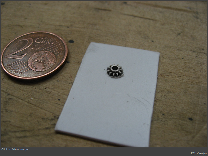

Added a picture of how you can easily make the gear thinner.
Bert
