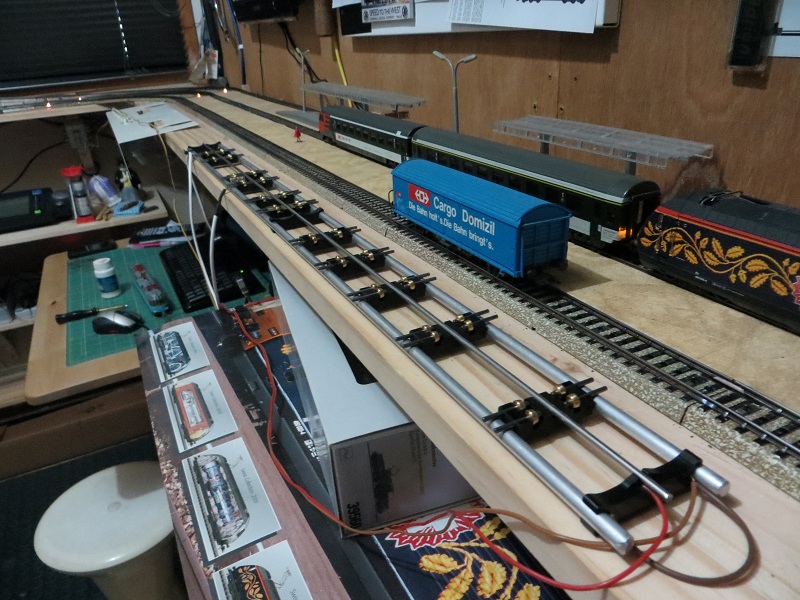

I needed a rolling road with a speed measurement device..
I already have a rolling road for my locos in the form of a Marklin 78100 and the 78111 Speed measuring device. Both are excellent products, but they can't interface with anything, and certainly not WindigiPet.
Along comes the KPF Zeller Rollenstand..

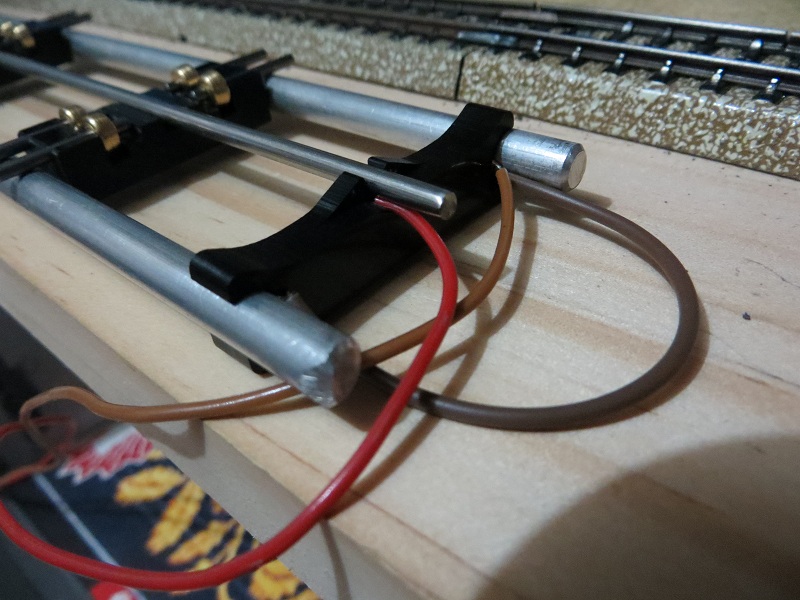

If you don't have a lot of money and all you want to do is see you models run, then this is a good product. It is nowhere near Marklin in terms of quality, but it does the basic job adequately. I selected the Maxi version, which comes with ten sets of rollers, because I have some railcars that will not fit on the normal HO model.
The only real complaint at this level is the method used to attach the power leads to the rods. (see the second pictures). It relies on the tension of the plastic clip to hold the wire to the side of the rod.

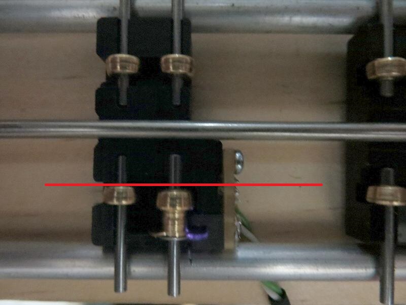

However concepts do not translate into a well made product. When I placed the first loco on the rollers, I noticed that the roller was stopping intermittently during the test run. A look at the roller assembly shows two problems. The first problem is that the rollers are tapered - probably to accommodate a variety of HO loco motive wheels. However, this means that the roller is not in contact with the rubber traction tyre on the loco.. In fact it runs on the edge of the wheel..
The second problem, as you can see in the photo below, is that the rollers are not in line.. So the loco wheel will turn the left hand roller, but the right hand one just moves away from the wheel. I fix this problem, I had to find some washers with a 2mm hole.. I started with brass washers, but found that it worked better with the nylon washers.

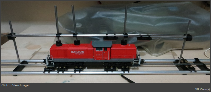

While this improved the situation, it did not fix the problem completely. The next problem was that the loco was climbing the roller and losing contact with the speed sensing roller. Cursing If I held the loco in place, the readings worked fine, but it takes 10 minutes per loco to run through all 30 speed steps - and there are better things I can do with that 10 minutes of my life multiplied by the number of digital locos to test..
So I then purchased the Roto-fix product to better attach the loco to the rolling road.. This product is actually designed to enabled you to place a loco on the rolling road and rotate the whole rolling road to see what is happening while the loco is running.. (See the first picture)
Anyway, I placed loco on the rolling road and applied tension to the vertical rods (they have foam pads, which do not damage the loco's finish). This approach solved the low speed problem, but caused so much load on the loco it would not go pass half it's normal running speed.. It was very very difficult to get the balance between keeping the loco on the roller and not adding too much friction to the loco..
In the end, I solved the problem by wedging the vertical poles in the front and rear of the loco to stop it moving forward or backward away from the speed sensing roller.
