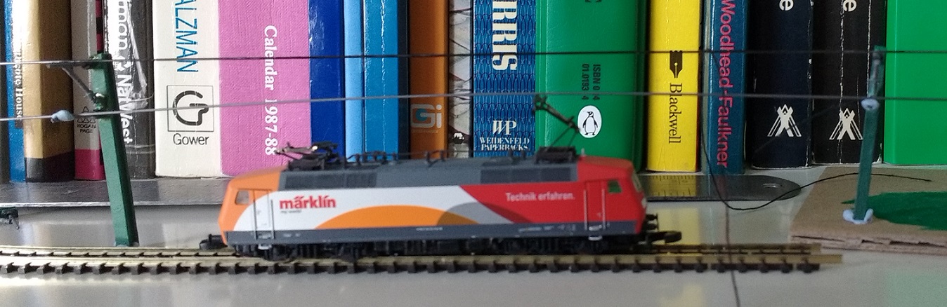

I just set up a quick test rig to see what was the best material to use for the wires. A thread or something like "EZ Line" just bowed too much. I then tried a 0.5mm music wire; the bow seemed acceptable. So I am going to use that for the electric wire and the carrier wire, and I will glue some threads inbetween to represent the cross-carrying wires. At the moment I can't decide which looks best, to leave the wire in it's natural state or paint it black (only the carrier line has been painted on my test rig).
