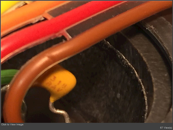

Hi Fred / all
So, I think here is the damn capacitor.......
It is the only thing I see connected to "B" in the TT. Actually, as you can see is underneath the TT
Unfortunately, the other leg, I cannot determine where it goes. It is welded to a wire that goes under that plate, and I tried to disassemble it but can't and I don't want to damage the TT....
Regarding the number, it is really small, but it looks something like 318??. As you know I am not an electrician, so any number sounds the same to me. Maybe to you it means something else. Hope you can see it in the picture....
Thank you!! I think we might be getting closer....

In fact that component is likely a ceramic capacitor, but the marking, if we follow standard marking, would mean 0.31pF, which is a very very low value, and a nonsense in the frequency range used here. Furthermore,it is not a normalized value (0.27 or 0.33 pF). Then it's not a standard marking, and i don't know what could be the capacitance.
Then a possibility to cancel the parasitic current due to that capacitor is to connect a capacitor on the 5233, as said before, and find the good value by trial-and-error. The value should be less than 10 nF, in order not to degrade the sensitivity.
I understand that you probably don't have capacitors at hand, for you are not electronician. Resistance could be used instead, but with, for sure, a deterioration of the sensitivity, and you probably don't have resistors at hand either .
May be other members could tell more about that TT capacitor?

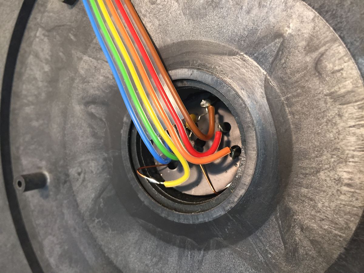

Just to provide a comparison, I've been able to take pictures of the below side of
my
TT.
-There is NO capacitor in
my
TT
-The below side side shown by Esteban is a bit different from mine
... Sorry to be not too helpful. I've forgot a lot from my electronic lessons in the past.
my
TT.
my
TT
fabrice
Hi Fabrice
Thank you for sharing your pictures.
You have been more than helpful, and I hope you still follow with me the next steps.... this is far from over!!
Let you know later if I was able to get the capacitors..
Esteban

OK, so the "318" capacitor is connected on one side to "0 right" and on the other side to an unknown destination.
The next idea, but I don't know if it will make progress us, is to measure the value of the current at the 5233 when "normal" detection occurs, AND when "NOT normal" detection occurs.
@Fred: Tell us if this test is useful or not, and if the multimeter will not interfere with the behavior of 5233

If I understand well, the B bridge is the center screw.
Could you try to check (visually) if there are wires/components connected to that B wire on the TT (both in the mobile part and static part)?
Could you measure the resistance between the B bridge (yellow wire of the ribbon, I think) and the leg of the "318" "capa" which is not connected to the brown wire? (Ohmmeter on 20 kOhm, TT without any external connection)? Make 2 measurements, inverting black and red probes.

Regarding your question of any connections to the "B", I cannot see anything. Maybe something hidden underneath that plate that can't be taken apart....
Actually, "B", as you say is the screw, it doesn't have any other wire connected to it (visible)
Hope it gives some clue

Strange behavior indeed! It's the contrary that what happenned when connecting an Ohmmeter to a large capacitor: The reading is very low at the beginning, and increases up to overtake the range of the ohmmeter! The kind of behavior you describe may happen when there is a voltage somewhere in the circuit. You confirm you made the test with no external connection to the TT at all ?
Anyway, your test means there is an electrical path between B bridge and one leg of the "318 cap", the other leg of the "318 capa" being connected to the "0 right", i.e. a path between B and "0 right", leading to a current detected by the 5233.
I don't know what to do, for we don't know what is exactly that path, and what it is for???
For me, the central rail of the track (B) and the 2 lateral rails of the track should go to the corresponding plugs of the fake board without any electrical derivation (as on the Fabrice'TT)!
There is still a possibility; it's to disconnect the "318capa" from "0 right".
But that should be avoided if the TT is still under guarantee!
Another possibility is to use the standard marklin occupation detection, between the 2 lateral rails, instead of a detection by current consumption.
It would be also interesting to create a new topic to ask members if their Marklin TT wiring looks like yours or like Fabrice' one .
And why not ask to Marklin, or your dealer, what is the purpose of the components connected on "0 right" or B bridge?

I can also go ahead and remove that "318 capa", actually the TT is no longer under warranty, so it wouldn't matter. The thing is that I would like to know, that even if the detection via the 5233 doesn't work, the TT would still need to be operative for everything else (including the connection to 7687) after removing that component. What do you think?
Hi Esteban,
I can't tell what will happen without that "318 capa" for I don't know if there are other added components, where they are connected, and what is their purpose. In fact, I'm not even sure the "318" is a capacitor for it's not a standard marking!
I was just suggesting to try and see. If you were to do the trial, desolder only 1 leg of the capa (the one connected to the brown wire) and insulate that leg with electrical tape. That way, you can resolder it easily if needed.
Fred

The problem has already been solved:
here
The "318" component purpose would be to suppress radio interference! Removing it solve the problem.
Fred

Hi Fred
As you may have seen, I also found this post, and wrote to the author because the pictures are no longer available. So I was hoping to get an answer from him.
As you know, I decided for standard (via s88) detection, and already worked. But I was really curious and today I removed (desoldered one leg...the one going to the brown wire "0 Right"), and guess what..... it didn't work!!
There was no power in the TT when I removed this leg....
Maybe I did it wrong? Did I have to remove both legs? What may have I missed?
Anyway, I soldered it again, so at the end the TT is functional again
If I can solve this, maybe I will be using this method (via 5233), because as you know, I don't have the insulators for doing it the other way..(yet..)
Thank you for all of your nice help!!!
Esteban
1 user liked this useful post by ecastrog

Hi Esteban,
So, as there is no power after removing the "318" component, that means that component is not a capacitor.
It seems that Jonas-sthlm had succeeded in doing so, but may be he was no talking about the same component.
I think I can't help more, for we don't know the whole electrical diagram, and trials "at random" lead nowhere. Fortunately, you can solve your problem using lateral rails detection.
Anyway, I thank you for your trial: even if the result is not positive, it increases the global knowledge of the forum.
Fred

I think I've found the reason why the 5233 doesn't run well with new TTs: See there (1st picture):
http://www.sb-modellbau....20Lokpilot%20Decoder.pdf
@Fred: You were right, there is an other device connected to yellow wire -"B bridge" (looks like a capacitor, but I'm not sure as connectors are not radial -may be a coil) -Yes, after passing the german sentence to the translator, it's a coil !
So, capacitor
and
coil must be removed for the 5233 to operate correctly!
Fabrice

I must say I am not yet understanding why it did not work when deconnecting one leg of the capa.
After your link, keeping that coil and capa may lead also to problems with the loco decoder !
fred

When testing my BR64 I found it makes a slight buzzing sound which becomes louder when on the turntable.
I decided to remove the capacitor and inductor from my turntable.
It was a royal pain in the ass to do since my turntable is installed, even with the centre being accessible.
To access the inductor you need to remove the capacitor, de-solder all the wires and then remove the plastic cover.
Here is that work performed with the inductor now exposed:
After removing the inductor and re-soldering the wires (now with yellow on the centre pin which was previously soldered to the inductor leg) here is what it looks like:
After re-testing I found no change with the buzzing noise of the BR64 so I am not sure if this work has helped me at all.
I will be using S88 detection for my turntable, rather than current detection which is what other users had problems with.
Edit: I also cut off the centre strip 'tabs' that stick out from the turntable that provide power to the spur tracks in analogue operation.
Since I run digital it was not required and also caused problems as it could occasionally make contact with the rails during rotation, resulting in a short.
