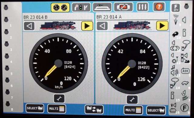

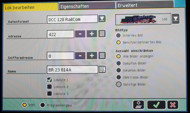

I've just made a discovery last night: ESU Loksound V4 Railcom plus.
It is similar to mfx and M4 but it has an open protocol.
The moment you put the loco onto the track it recognizes the loco automatically with all, its functions and more.
I'm still in the beginners learning stage as I got a surprise when this symbol of the railcom plus logo came up on my ECoS. asked me different questions and in the excitement and all, I had a loco registered by itself.
Although I've already registered all my locos manually, e.g. name, loco address and speed steps, I have to figure out now how to manipulate the existing locos to the new arrivals.
Another feature has been added, when the loco goes into curves the rims squealing can be activated.
Although I'm delighted with this new feedback system, I haven't learned all the other bits and pieces as yet.
I envy all other analog model train enthusiasts, I thought they keep the digital system simple by just pressing a button.
More info will follow as I get the hang of it.
For some of you, may be it is old stuff and you've known about it years ago.
regards.,

I've just rewritten the BR 01 loco, which I've downloaded the soundfile (BR 01)from that loco instead of the BR 23, it seems to have the same amount of cylinders but many more functions.
Other Version 4 lokpilots I have put onto the track and nothing has happpened, but the instruction booklet mentioned, so long the railcom plus is activated, the decoder will automatically register with the ECoS, when hitting the railcom symbol.
I just have to watch and observe were I can see the difference and how I can incorporate and change the already registered locos (version 4 decoders) and their addresses.

When I downloaded the BR 01 sound file, not being aware of the railcom plus protocol, I've read about something somewhere but put it aside as it was produced by Lenz.
I than noticed a loco had been registered under unknown loco under BR 01 and I've looked at the side of the function buttons and there are all these function symbols I've never seen before.
there must be other things in life than just sitting in front of your ECoS and observe the miracles appear in front of your eyes.
