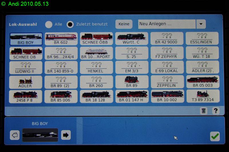

CS2 shows locos for selection in a grid (6 columns, 5 rows). You can have either a "most recently used" list sorted by last usage (this is a default) or a full list sorted by name. If you have more than 30 locos, there will be more than one page. The list cannot be filtered, so if you have more than 30 locos you must find the right page, then locate the loco on that page.
A screen shot can be found here:
http://www.andreas-huste...bdd6ffff8130fffffff0.jpg
I find it easier to find the right loco with the CS1R - especially for large collections.
