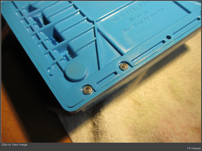

When I repaired one of mine, I used a 4-40 screw and nut to hold things together. In metric a 3mm screw and nut should be pretty close. The screw had to be cut to the correct length. I used hardware that I had on hand, that's why there is a difference between the front and back. I only had a couple of thin nuts to that could be used on the underside of the case so I used them in the front and used the thick ones in the back with the screws sticking up.
trafo repair 01.jpgtrafo repair 02.jpgtrafo repair 03.jpgtrafo repair 04.jpg
Many thanks Peter!
What a simple idea!
Thanks heaps,
Sven
