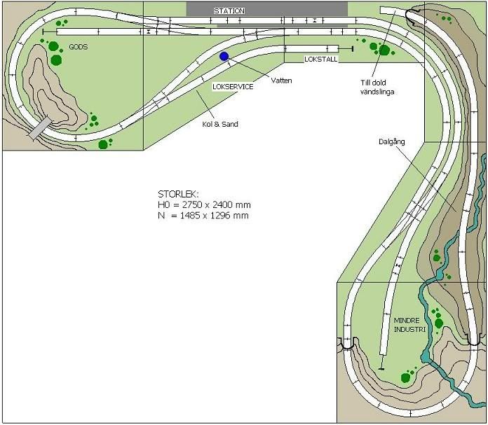

After years of large sprawling layouts,having moved and downsized I now have room for an 8 by 4 layout. I am having difficulty in planning this. Idealy I would like a tail chaser, an in and out and a figure of 8. However there doesn't appear to be enough room.different levels might be the answer. Any track plans would be helpful

Having room for an 8x4, usually means that you have a 12x8 foot room (assuming 2 feet access space all around). Have you considered doing an around the walls or walk-in type layout instead? With that kind of space you usually get a longer run if you avoid the basic 8x4 shape.
Otherwise, take a look at this way to split and re-arrange a 8x4 board:
Outer size is 8x9, but you can butt it up against a corner, since it's no wider than 3 feet at the widest parts. The descriptions are in swedish, but the plan should speak for itself. The right hand track disappears down into a valley and then to a hidden return loop below the main level. Here you can have a small storage yard for a couple of trains, so you vary the traffic.

I like the general arrangement of this layout. I wonder, could it be made to fit in an 8x8 room? That's all I have to work with, myself. I'm using M-track.
Bill
[size=1" face="Verdana" id="quote]quote:Originally posted by Laffe
<br />Having room for an 8x4, usually means that you have a 12x8 foot room (assuming 2 feet access space all around). Have you considered doing an around the walls or walk-in type layout instead? With that kind of space you usually get a longer run if you avoid the basic 8x4 shape.

[size=1" face="Verdana" id="quote]quote:Originally posted by obxbill
<br />I like the general arrangement of this layout. I wonder, could it be made to fit in an 8x8 room? That's all I have to work with, myself. I'm using M-track.
Bill
I didn't make this plan originally, but I can try to fit a similar plan with M-track. Give me a couple of days though...
/Laffe

Thanks, Laffe! I really appreciate it. My plan was to just lay track and see how it works. Some kind of plan would really help me. Smile I plan to just use 5100 radius because of space.
