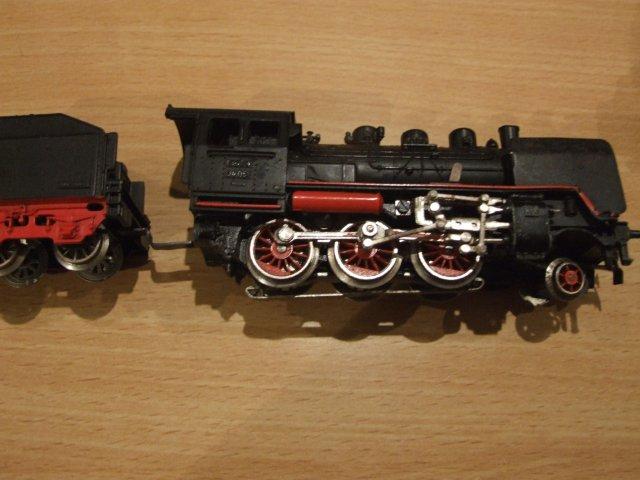

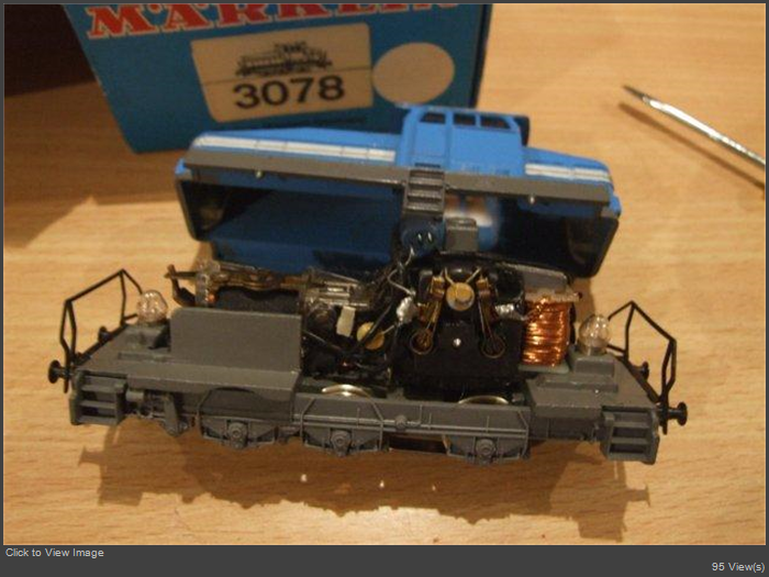

after joining this forum about two weeks ago, I am in serious trouble with my wife and kids - they all think I have gone mad - obsessed! Ha, I love it.
Below is a series of photos of some of my Loco's, all mine and were purchased in 1977 and 1981. The 3089, I bought 2nd hand in a shop in Germany on a whim in 2010. the 3003, I bought off a kid in my class in 1982 along with all his other Marklin for $20, so not sure how old it is.
I really want to go to digital with all of these and convert them myself. videos I have found have shown it done to Delta models, but mine are older. I know it can be done, but it I need to identify the motors that I have. Any advice or point in the right direction will be much appreciated.
Am I biting more off than I can chew/
Also, If I am starting all of this up again, (and I think I can afford it), I prefer to begin setting up with good stuff that will last me years. I want to use my original M-track - i am a fan of this.
so what decoder/chip kits do I need to buy?
What digital control stations should I look into?
Should I buy a digital starter set, to get the transformer, and some sort of controller?
Sir Timbo attached the following image(s):

To answer your question about what is needed to convert let me start with the most basic and simple conversion.
1) You need a decoder, this will replace the reversing unit.
2) You need a a permanent magnet which replaces the field coil (this is the thing with the wire around it that surrounds the 3 or 5 pole motor and is wired to the reversing unit. (The permanent magnet comes in three styles which match the motor you have, either a SFCM, LFCM or DCM)
3) You will need LEDs to replace your lightbulbs and you will need a resistor to reduce the current from the decoder to the LED so you don't burn it out.
That really is everything you need to do a conversion. Now if you decide to upgrade the motor from a 3 pole to 5 pole motor you will need to do the following. I have never felt the need to do this but many on here do.
4) Replace the face plate over the motor,
5) Replace the 3 pole rotor to a 5 pole rotor.
The other thing to remember is you have a few manufactures to choose from, Marklin of course for the decoder and magnet and another is ESU. I have used ESU exclusively for the conversions and have been very pleased, they are cheaper and the decoders are almost idiot proof (very important for me). The decoders that ESU has are referred to Lokpilot V4 and Loksound V4. As I haven't installed any Marklin decoders recently I can't really speak to them but they should be just as easy to install and the part numbers should be easy to find.
Finally, after looking at all of your stuff they all can be easily converted to Digital. If you have more questions feel free to ask.
Chris

Can I just comment on Chris's post above.
I have made numerous conversions without having changed a single light bulb, so I strongly disagree with number '3'. I accept that it is nice to use LEDs instead of bulbs, but it is not a necessity. I would give this less priority than changing the motor to 5 pole.

firstly Chris,- so whats the difference between Lokpilot V4 and Loksound V4?) Loksound has sound?. from what I can tell, as all my current loco's are 30xx series they are all LFCM motors. Also I have not found anything on you tube to watch this, have you seen anything like this/ - a tutorial? Or are the instructions pretty clear?
And is the 5 pole motor worthy to go up to?
Also, what about converting the little 3000 tender loco ( the one we all got with a starter set) I know it's not cost effective - but is there space to do this? I am sentimental towards my very first loco.
Thank you both for your input.
Tim.

to convert your little gem, 3000 (older type), a conversion kit 60943 (SFCM) is needed, I prefer ESU decoders, you can use a 21 pin decoder V4 lokpilot and an adapterplate 51967 and both adapterplate and decoder will fit into the space where the reversing unit sits.
You've answered your own question regarding loksound and lokpilot and yes the loksound has sound.
there is nothing special about converting a loco from analog to digital.
